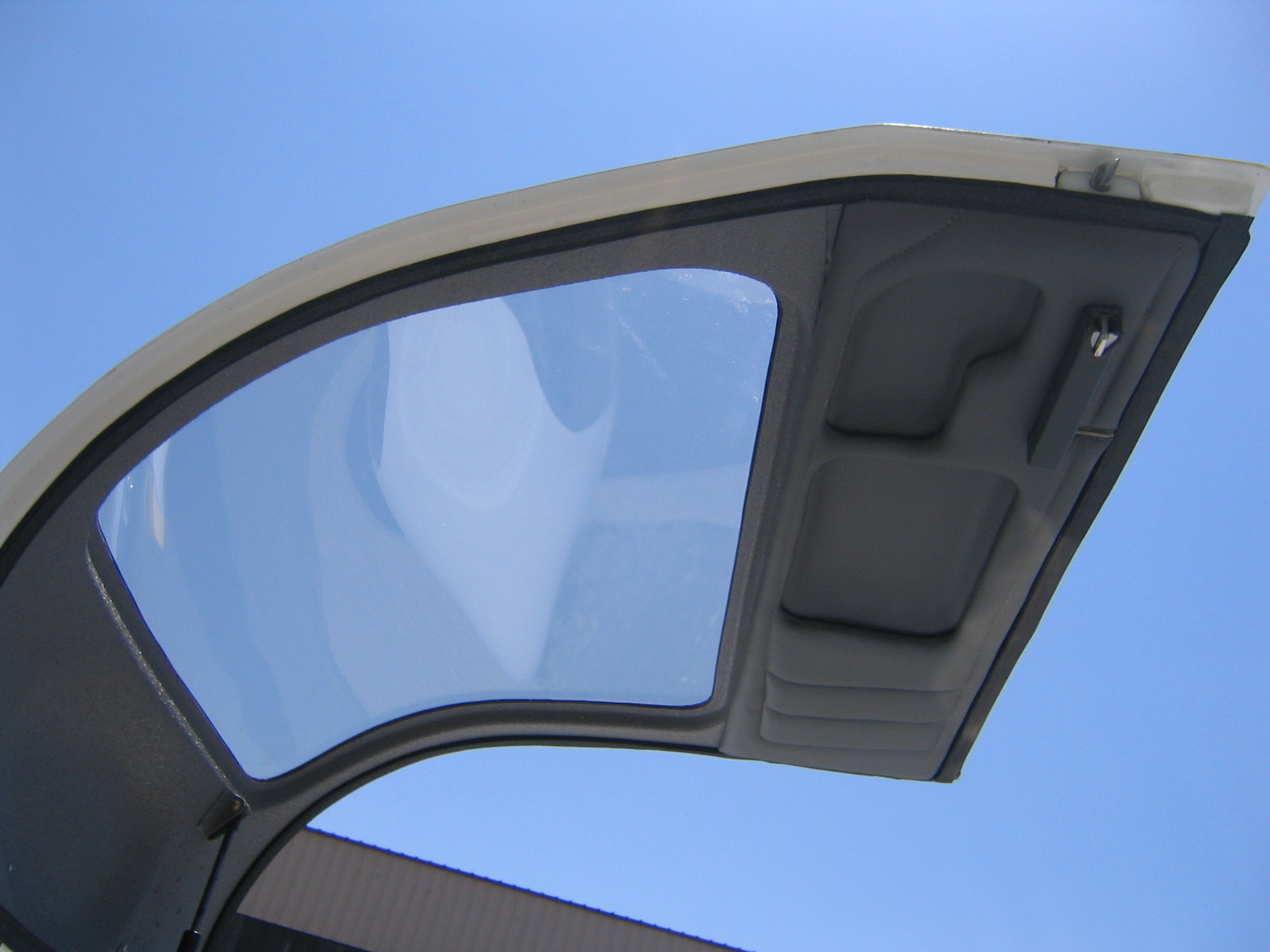

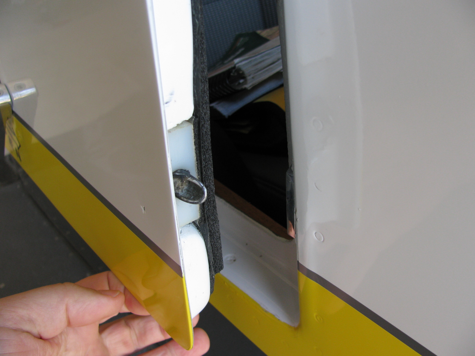

McMaster-Carr P/Ns and descriptions:
293745K23 OIL-AND WATER-RESISTANT VINYL/BUNA-N FOAM, ADHESIVE-BACK, EXTRA-SOFT, 1/8" THK, 3/4"W, 50'L $8.29
393745K33 OIL-AND WATER-RESISTANT VINYL/BUNA-N FOAM, ADHESIVE-BACK, EXTRA-SOFT, 3/16" THK, 3/4"W, 50'L $9.34
493745K43 OIL-AND WATER-RESISTANT VINYL/BUNA-N FOAM, ADHESIVE-BACK, EXTRA-SOFT, 1/4" THK, 3/4"W, 50'L $10.26
[img]cid:ii_12425921e403e423[/img][img]cid:ii_1242591677224e27[/img]
I initially ordered all three thicknesses.  When I reapplied the seals after paint, I only used the 1/8" and 1/4".
Close the door, mark the outline of the door opening with a sharpie on the door, and use the line as the ID of the seal.  If you just cover up the line you get a nice even reveal when the door is closed.
Build up any gaps larger than 1/16" with varying thicknesses, then overlay the whole diameter with one layer of 1/8".
The door will be hard to close the first time.  Push it closed and leave it overnight.  The seals take a set and develop a definite groove, but they do not offer any resistance to closing after the take the shape.
One more downside:  The adhesive is not particularly aggressive.  Over time (more than a year) the tightest radii have begun to creep a bit, maybe 1/8".  I suspect that I may need to replace the seals after another year.

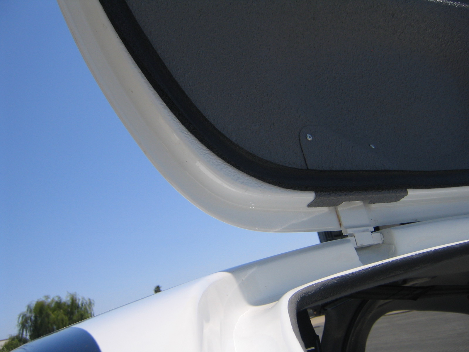

Here's the "backwards" bevel to help ensure that the pin engages the hole correctly.  Since I have metal guide blocks, I know that the pin makes contact at the complete diameter, not at the bevel.  The aft pin is the same way.
