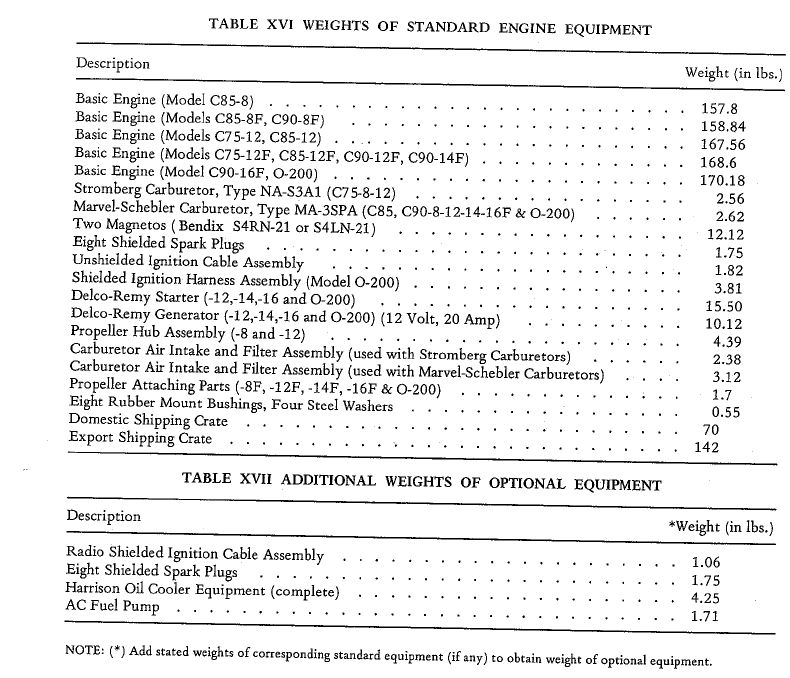

Had me going there I had to look it up... thought you were saying that the C-85 was hand prop only. I get about 195 lbs for the -8 model.
C Series weights

you're right kevin I should have checked more closely. But turning to page 16 of the manual you see that the -8 engines have no provision to fit a starter or generator and cannot be retrofitted either.
The choice is a C85-8F at 159lbs with no electrical systems, or C-85-12F (169lbs) / O-200 (170lbs) plus 26lbs of starter and generator, by the time everything else including oil is put in the installed weight is over 220lbs.
Because I don't wish to expose myself to hand starting I would choose the heavier option regardless, but my 701 is of the heavier empty weight version and without any extra wing it is on its practical flying and handling limits with just the 2200a engine, when I operate 2 up and full fuel.
