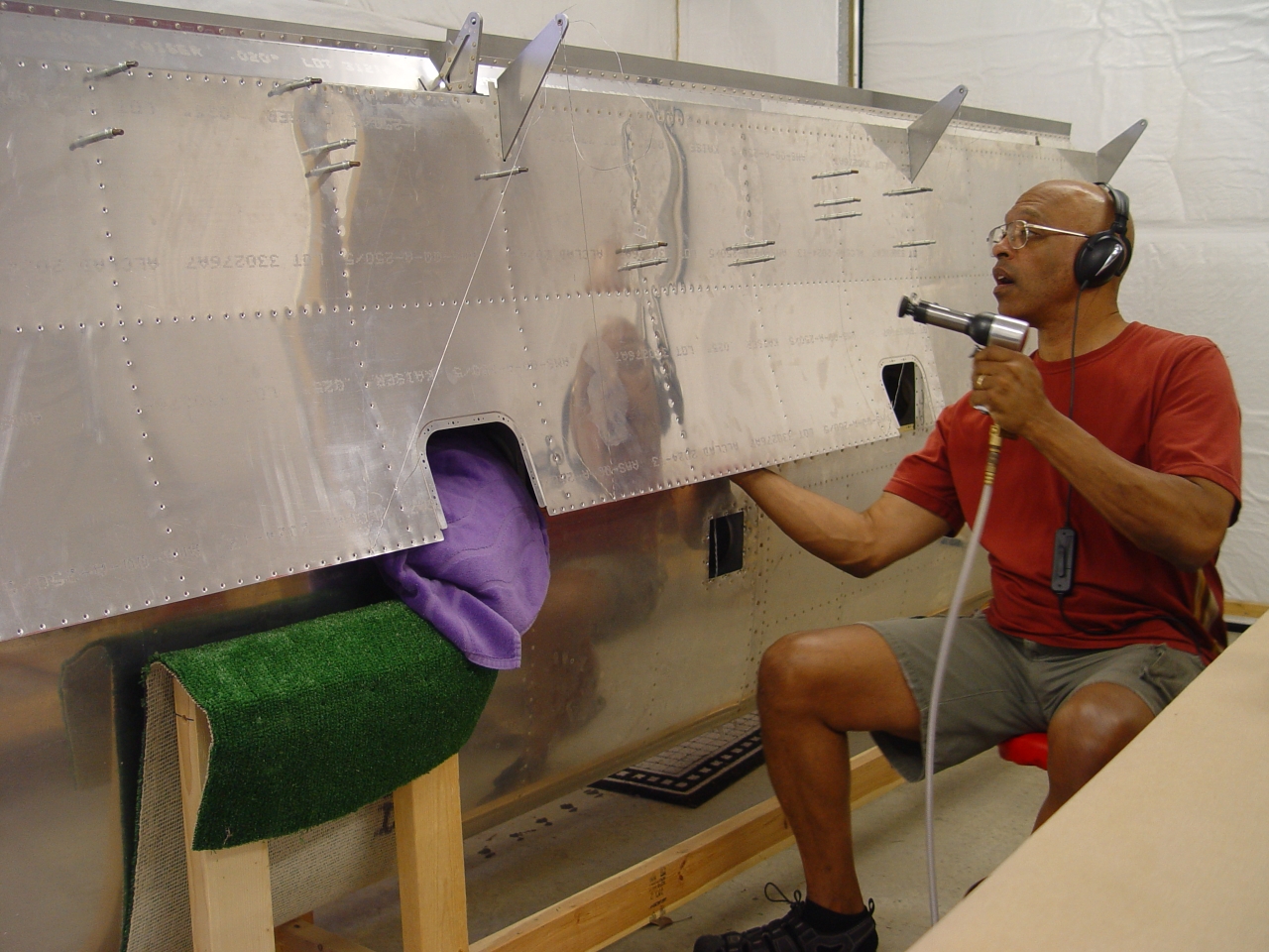

FWIW - I think I made similar comments previously but -
I did mine in a vertical stand, one person.
I found that a small tungsten bar was very handy but not exclusively.
The lighter, bigger iron bucking blocks were also useful
Thank Deems for the safety wire technique to hold up the skins (see
photo if I successfully attached one)
Remember to check that the skin doesn't overlap or bind on the leading
edge skins - I had to file mine down to fit well - It's painful if you
find out too late

Phil.Perry(at)netapp.com
PostPosted: Tue Sep 29, 2009 7:08 pm    Post subject: Before Closing Up The Bottom Skins? Reply with quote
Hey Bill,
ANC in the shop? Maybe a MP3 player in the mix too?
Now that's hearing protection!
MauleDriver(at)nc.rr.com
PostPosted: Wed Sep 30, 2009 4:51 am    Post subject: Before Closing Up The Bottom Skins? Reply with quote
You like that 'eh? I got that headset as some sort of thank you gift.
It worked well but since I prefer Web listening, I just used the ANC.
That is until I was doing some job near whirling machinery and decided
it was safer to give up the ANC... so I snipped the cord off.
The real challenge was getting a wireless internet signal into a metal
hangar 200 yards from the router. I'll have to post a picture of my
"Cantenna".
Bill "who doesn't think he could build this thing without Web access in
the shop" Watson
