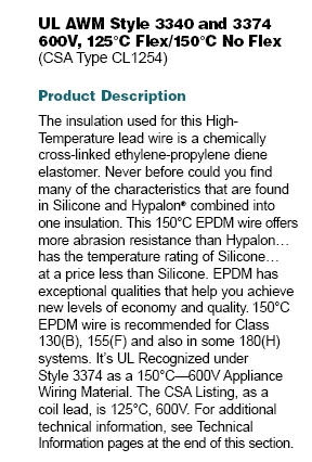

Thanks for reminding me of that Sam. A guy
at a welding store told me that the two-layer
cable lasted longer in the field. Little nicks
in the outer jacket tended to propagate cracks
through to the strands when the cable was flexed/
stretched. By making it two layers, the gap
was a "crack stopper" while the inner layer
maintained environmental integrity.
http://aeroelectric.com/Pictures/Wire/4AWG_Welding_Cable_1.jpg
It seems a logical explanation. Of course,
the cables in our airplanes don't get stretched
across gravel drives and run over by dump-trucks.
The Anchor brand welding cable illustrated above
has an HDPM outer jacket which is revered for
its flexibility and toughness. Here's an excerpt
from a wire catalog describing this insulation.
[img]cid:.0[/img]

Hey, good find on the web-source! Looks like
their prices are really good too. As you can
see from their offerings, there are MANY different
kinds of insulation . . . EPDM is not the magic
material, just one of many that would be
suitable. I didn't intend that one zero in
on EDPM in that manner. The fact that a reel
of wire (or a catalog page) cites EDPM says
that you KNOW what's being offered. That reel
of shiny stuff with unknown and/or questionable
insulation material MIGHT be okay. Without
identification or other qualification data
like materials or temperature ratings, it's
good to move on and consider other sources.
Looks like the WesBell folks are an excellent
source of wire suitable for use as fat wires
in your airplane.
