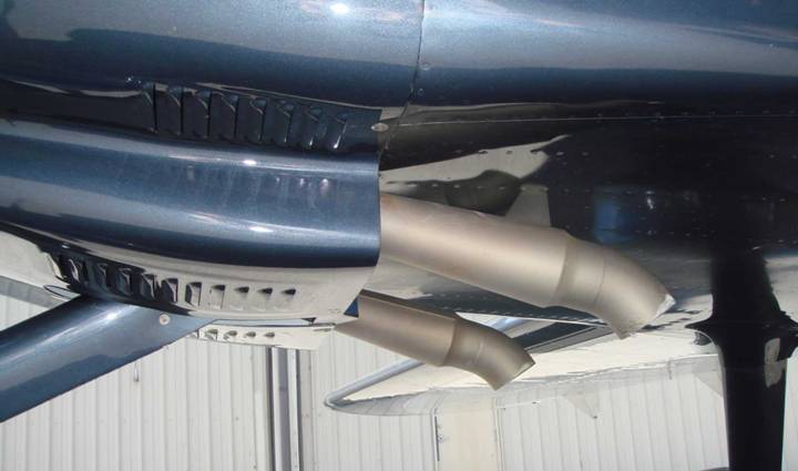

PostPosted: Sun Sep 27, 2009 5:59 pm    Post subject: James plenum question Reply with quote
Here's how I did the ones on my 6A.....
 Filesize:  679.47 KB
 Viewed:  7908 Time(s)
robin1(at)mrmoisture.com

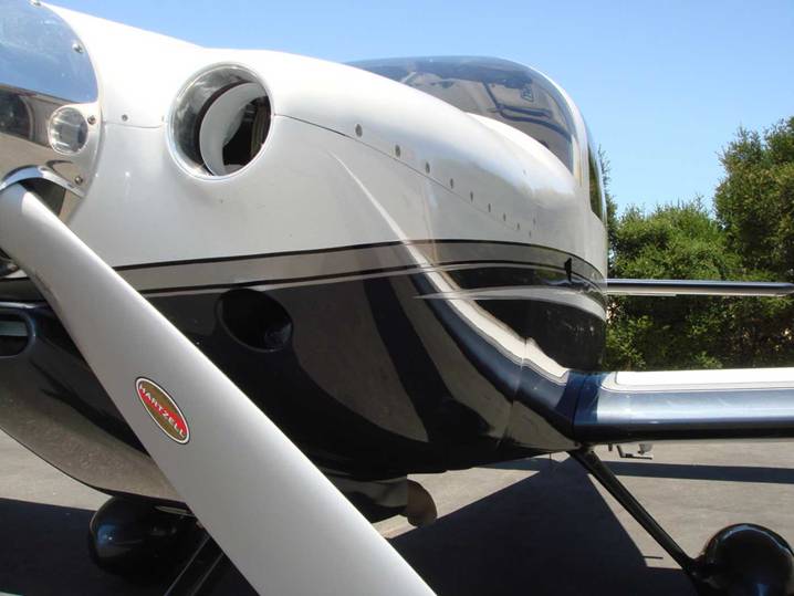

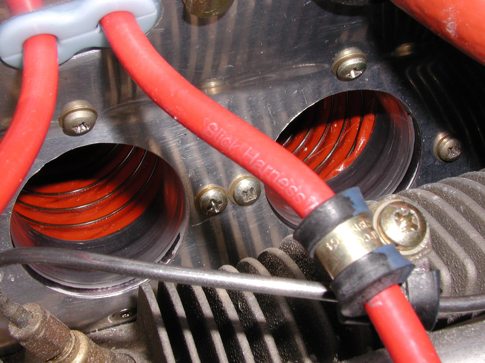

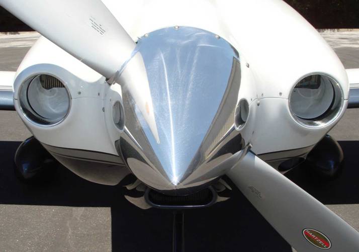

PostPosted: Sun Sep 27, 2009 6:46 pm    Post subject: James plenum question Reply with quote
Lenny,
  Because of high temp issues early on we upgraded and relocated the oil cooler to accept RAM air from the front of the cowl. We sealed the rear hole leaving all the cowl/plenum air for cooling the cylinders. While I hope temps will not be an issue with your build I suspect you will experience similar thermal challenges. Assuming I were using the James Cowl/Plenum again (highly doubtful) I would consider side louvers as the under cowl louvers were beneficial but still not sufficient to keep temps in an acceptable range. I have even toyed with the idea of converting the Plenum back to standard baffles but there are too many unknowns to go that route at this point in time.
  I hate to sound like an RV-List whiner dealing with the Garmin issues and the James Cowl/Plenum cooling but these are real life challenges and I sure hate to have people see my beautiful front end and think it's all rainbows and unicorns. That being said I did display the -10 at SBP Airport Day last Saturday sitting across from a fleet of Cirrus and a bunch of other experimental & certified aircraft and we can be pretty proud of the decision we made to build these airplanes. Once you have a flying -10 there are some planes you no longer have the need to envy.
Robin
Note: Ram Oil Cooler inlet just below Pilots Side Inlet

Lenny Iszak
Joined: 23 Mar 2008
Posts: 270
PostPosted: Mon Sep 28, 2009 6:04 am    Post subject: Re: James plenum question Reply with quote
Robin,
Thanks for you input. That's a brave idea to cut into the lower cowling and move the oil cooler. How did it work out? By the way, do you have some before and after numbers for oil temps?
I have the stock engine, so I hope I'm not going to have too high temps but everyone reassures me that I will so life is good, i'm assured to have a "hot" airplane Smile
Were your CHTs ok? Did closing off the oil cooler hole in the back help your CHTs at all?
Lenny
