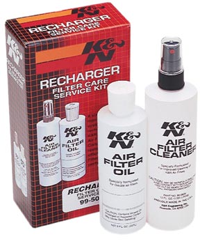

From Aircraft Spruce
K&N RECHARGER® FILTER
SERVICE KIT
[img]cid:part1.06060707.01040507(at)newwavecomm.net[/img]
P/N 08-00722 $10.25 [img]cid:part2.00020608.01090901(at)newwavecomm.net[/img] [img]cid:part3.03090307.04030309(at)newwavecomm.net[/img]
K&N FilterChargers® use a specially formulated oil to attract and suspend dirt to the cotton-gauze filtration surface. Over time, dirt accumulates on the filter and airflow can be reduced. This is where the K&N ReCharger® Filter Care Service Kit comes to the rescue. Included are a cleaning solution and dirt-attracting oil, both of which are formulated specifically for K&N's cotton-gauze filter media.

Also, do not "soak" the filter or you will have oil dripping out it into your bottom cowl for weeks. Apply the oil sparingly to all the folds and let it penetrate for awhile, then check for bare spots and go over them again.  You can get the K&N oil in a spray can at most automotive supply stores and that makes it much easier to coat the element thoroughly without over doing it. Just a tip learned the hard way.
