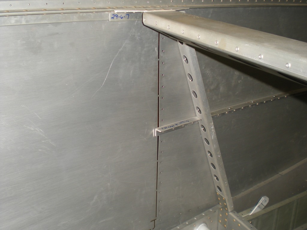

Attached are two photos of four offenses.
Baggage Seal photo shows:
  The longeron extending into the baggage door opening.
  The baggage door seal angles (top of baggage door) – not trimmed.

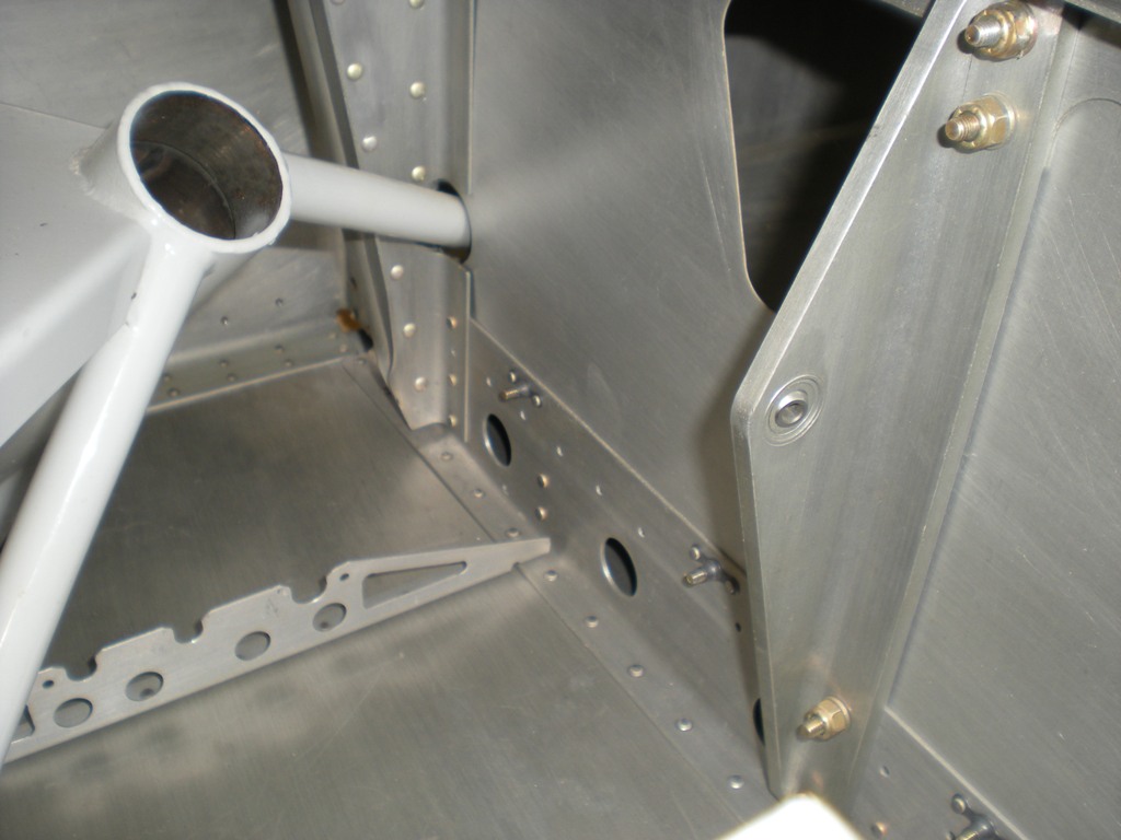

1084 and Control Column mount photo shows:
  The 1084B’s missing. The bottom half is riveted to the floor

From: Richard Bibb [mailto:rbibb(at)tomet.net]
  The control column brackets without the hatched area removed.
