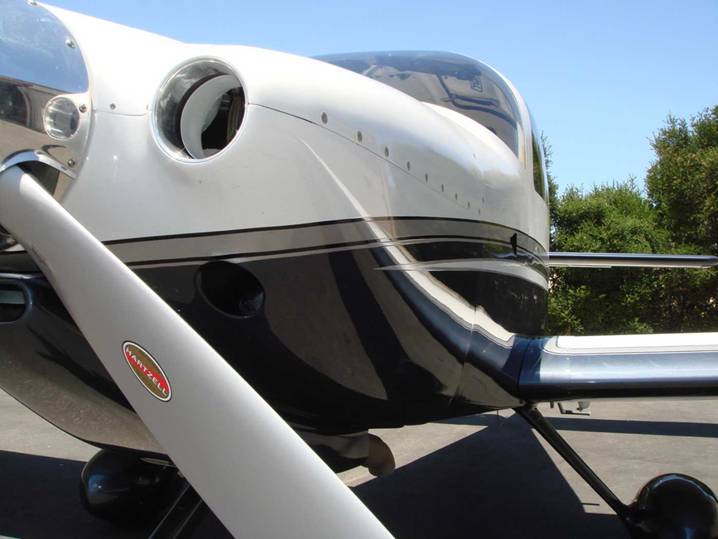

In following the thread on the James Plenum and various others with cooling problems I have been thinking about potential alternatives for my RV-10 setup (it’s down the road as I’m just starting main fuselage).
For the aerodynamicists out there: How would a larger intake scoop that had in internal split to feed intake air as well as oil cooler input work IYHO? I’m thinking making the inlet a large affair that has a flow divider to send air into the FI body and a separate path (via flex hose) to the Oil Cooler, This allows the plenum to concentrate on supplying cooling air to the cylinders without having any flow diverted to the oil cooler. Similar to Robin Marks approach shown below but with the input combined into one input “hole” in the cowling.
As an electrical engineer I should know better than to delve into the world of fluid dynamics but I figure that is what the “experimental” designation is all about.

Note: Ram Oil Cooler inlet just below Pilots Side Inlet

Caution, my current aircraft has an oil cooler mounted on the lower cowling, not much lower than where Robin's inlet is located. Unfortunately, the manufacturer did no testing of that location, and in a climb it is enough of a low pressure area that flow can actually reverse, passing from cylinder bottoms out the oil cooler. Not good, and most every example I know of runs 210-215 oil temps. The only solution is for my aircraft is to relocate the oil cooler to the rear top of the engine baffling. I suppose what really needs examining is whether the engine air outlet is large enough or could benefit from cowl flaps. It is unfortunate that the prototypes didn't get any testing in AZ or TX to optimize engine cooling.

Well I wasn’t thinking of mounting the oil cooler on the cowl just deriving the source of air for the cooler (mounting in stock location but perhaps modified mount to reflect change in air source geometry) from a combined induction/oil cooler inlet. The idea is to eliminate the source of air for the oil cooer from the rear of the baffles (whether inside a plenum or not) as to increase cooling air for the cylinders. That creates the problem of creating an air source for the cooler. Rather than create a separate inlet I was thinking of creating a larger “mouth” on the below-cowl scoop for the induction and creating some sort of flow divider to send some air to the inlet and some to the cooler.
Not being educated in fluid dynamics I’m looking for general guidelines as to an efficient method of engineering such an inlet/splitter combo.

Like you, my background is in electronics, so my comments may not help!
I don't think the problem is in robbing the available air from the
cylinders, it's finding a balance in the area of entrance air Vs exit
air, and finding a less-obstructed path for the air. Lopresti was an
expert at it, and his son is carrying on the effort. Look at the size
of the holes in some 'certificated' cowls Vs the Swift Fury or the
Lancair. I'll go the plenum route ..... cowl seals leak ..... and I'll
use a manometer to try and balance the pressures. Providing for good
exit flows seem to help a lot.
cooler.
Thanks for the warning…..

My thought was it would be easier to balance the flow if you didn't have a
big 3" round exit on one side of the engine. But I'm waiting for the
aerodynamicists to weigh in here...

Exit flows. Delta P seems to be the most productive area of pursuit.
Get the low pressure lower cowl more efficient at extraction - both the
plenum air and the exhaust gases.

This is an interesting discussion. I have a friend (Bob Cole) with an RV-6 that has done some extensive modifications to his cowling and I plan to follow in his footsteps. Let me tell you a little about Bob. He couldn't get the performance that he expected from the Katto prop he had made so he learned about prop design and manufacturing and made his own. He is on his fourth 'tweak' (prop) and has it just about what he considers perfect. He decided to build his own exhaust system so he learned about designing balanced flow exhaust systems and made his own. He has since made several further modifications to further improve the performance and keeps working on the next knot of speed, degree of cooling, etc. In each case he gets a base line measurement of performance before he makes his changes (they don't all make it better).
So about improving cooling. Bob's approach has been to use an airspeed indicator to measure the change in the differential air pressure before and after any airflow modifications. He simply runs the indicator tubes to the front and back of the testing area, gets a baseline and checks again after the change. Like many others, he found that reducing the air inlet area on the cowling improved the air flow through the cowling. Something about air being damned up in that area when the opening is too large, which is typical of the Van's design. He also worked on getting the air out more effectively with a ramp on the back of the cowl. One of the things that made a big difference for him was to pay special attention on making sure that the seal to the engine baffling was 100% effective (no leaks). It is the simple things that can make the biggest difference.
I saw how much information you can get from the measurement of the differential pressure (air speed indicator) throughout the engine area that I installed a small device from Honeywell (sourced from Allied Electronics) that will allow me to electronically do what Bob has done without having to run the tubes through the firewall (2-wires). I expect to make various modification to the -10 for cooling efficiency, etc. (not flying yet).
The bottom line to this conversation is that getting more air into the cowling is often more of a problem than a solution. Also, get a good baseline measurement before you make any changes. And also to thank the Bob's of the world for their curiosity, intelligence, gumption and incredible talent.

I'll venture into the oil cooler mount/high temp waters with some thoughts:
1. There was a good article a few months back in one of the kit magazines
on cooling air flow into the engine. The bottom line is once the top of the
cowl (or plenum) is pressurized, the cylinder airflow (lbm/hr) is fairly
uniform. My take from this is the air coming off the back for the oil
cooler does not affect one side more than the other.
2. This article also discussed the relatively high pressure area at the
front top of the cowl caused by air bouncing off the rear baffle. The
lesson learned is make sure the front cowl seal is in good shape.
3. The third take away from the article is huge gain received from
smoothing the cowl air inlet passages. For the James cowl this is done by
design. For the Van's cowl this is done by adding the top cowl inlet ramps.
4. While the standard Van's mount has clear advantage for installation
ease, I can't see how multiple redirections of air flow can go any good. I
am not using this standard oil cooler mount in my project.
5. Talking with others, I get the impression that the mid/aft cowl region
is a relatively high pressure area. This would contribute to a lower
differential pressure across the oil cooler (in the standard mount) and thus
lower air flow.
6. The other heat problem I see are the cabin heat valves. As they are
shut on hot days, the more than ample heat muff hot air bounces off the
closed valves directly toward the fuel pump. In addition to heating the
wrong component, I would guess this additional air pressure in the aft mid
cowl region contributes to the less than adequate differential pressure
across the oil cooler in the standard mount.
What I'm doing:
1. Using the James Cowl and plenum
2. Mounting the oil cooler aft of the rear baffle with a direct connection
for air flow.
3. Mounted Cool Mat between the cabin heat valves and over the top and
front of the valves. The objective is to isolate radiant heat from the
firewall and tunnel and redirect the unused hot air down toward the bottom
of the cowl.

"I installed a small device from Honeywell (sourced from Allied Electronics) that will allow me to electronically"......could you be a bit more specific about this device. Sounds like something I need to look at. Very interesting discussion! Dan

This is an interesting discussion. I have a friend (Bob Cole) with an RV-6 that has done some extensive modifications to his cowling and I plan to follow in his footsteps. Let me tell you a little about Bob. He couldn't get the performance that he expected from the Katto prop he had made so he learned about prop design and manufacturing and made his own. He is on his fourth 'tweak' (prop) and has it just about what he considers perfect. He decided to build his own exhaust system so he learned about designing balanced flow exhaust systems and made his own. He has since made several further modifications to further improve the performance and keeps working on the next knot of speed C degree of cooling C etc. In each case he gets a base line measurement of performance before he makes his changes (they don't all make it better).
So about improving cooling. Bob's approach has been to use an airspeed indicator to measure the change in the differential air pressure before and after any airflow modifications. He simply runs the indicator tubes to the front and back of the testing area C gets a baseline and checks again after the change. Like many others C he found that reducing the air inlet area on the cowling improved the air flow through the cowling. Something about air being damned up in that area when the opening is too large C which is typical of the Van's design. He also worked on getting the air out more effectively with a ramp on the back of the cowl. One of the things that made a big difference for him was to pay special attention on making sure that the seal to the engine baffling was 100% effective (no leaks). It is the simple things that can make the biggest difference.
I saw how much information you can get from the measurement of the differential pressure (air speed indicator) throughout the engine area that I installed a small device from Honeywell (sourced from Allied Electronics) that will allow me to electronically do what Bob has done without having to run the tubes through the firewall (2-wires). I expect to make various modification to the -10 for cooling efficiency C etc. (not flying yet).
The bottom line to this conversation is that getting more air into the cowling is often more of a problem than a solution. Also C get a good baseline measurement before you make any changes. And also to thank the Bob's of the world for their curiosity C intelligence C gumption and incredible talent.

This is a familiar topic. Wink I have the James cowl/Plenum,
Live in AZ and have to deal with heat issues (Today's high will reach
107!). I have been through several machinations in an attempt to deal
with heat. Ton's of louvers on bottom of cowl, increasing the lower cowl
exit area 5-10%. Plenum rework, baffle sealing. I still have the oil
cooler mounted in the stock (Van's) location. My current temps are
'manageable'. Everything is linked directly to OAT, the cooler the
better. With OAT of approx 90-95, On Take Off, I will see Oil temps
climb to 210-215 if I keep airspeed up to 120-130 kts. Hottest cyls CHT
seem to peak (at) 400-405. At altitude oil temps come back to 195 and CHT
to 360-380. On our trip back east (ie. cooler temps) we saw oil temps
175-185. I consider my temperatures on the high side, but am worried
about overreacting until I get some more experience in some lower
temperatures.
One approach I have considered is relocating the oil cooler to behind
the baffle (#6 likely). Initially I didn't think there was enough room,
however I saw an installation on an F1 Rocket
http://www.pflanzer-aviation.com/Engine9.html which got me thinking, I
borrowed an unmounted oil cooler and did a loose test fit and I think it
could be made to work.
Deems Davis

I've often wondered if a more direct route to the airflow would help the oil
cooler. Would this location give enough room for "exhausting" the hot air?
I wonder what it would do pressure wise for air behind the baffling?
I sure wish somebody would figure this out Smile.

I've been interested in the oil cooler thread ...... because I'll be
there someday! One other poster measured the pressures across the
cooler, but I couldn't find it .... anyway my thoughts were a plenum on
the output side to deflect the air towards the lower cowl outlet .... or
a dedicated louver ..... instead of just letting it blow into the
pressurized lower cowl.

I tried that. ........didn't help
http://deemsrv10.com/album/Phase1/slides/DSC07522.html

PostPosted: Mon Sep 28, 2009 2:31 pm    Post subject: Ram Air Oil Cooler Inlet - input requested Reply with quote
I was thinking more enclosed. If the pressure differential isn't great,
exhausting the oil cooler air into the lower cowl just won't have much
air flow. I'm having trouble putting my 'concept' into words! If you
have a plenum over the engine .... with no leaks around the engine .....
all the air coming into the plenum exhausts into the lower cowl. The
pressure differential is the drop across the engine. believe that if
the pressure difference is zero, you have the lowest cooling drag .....
what goes in goes out easily. With the oil cooler fed from the plenum,
and no pressure drop across the engine, then there is no air flow
through the cooler. Ducting the entire oil cooler air into the ramp
next to the opening should have some venturi effect and increase the
negative pressure on the hot air. Does this make any sense??? Have I
gone off into another reality here????
Deems

PostPosted: Mon Sep 28, 2009 2:49 pm    Post subject: Ram Air Oil Cooler Inlet - input requested Reply with quote
In reality there is a pressure differential from the top of the cylinders to
the bottom. Lycoming recommends I think 6" in order to achieve proper
cooling. I don't know of we are seeing that in the 10. More things to
check out.
