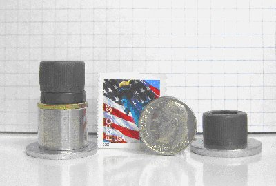

Tow Bar
Here is the one I use:
http://store.wagaero.com/product_info.php?products_id=8119
I also order and installed this:
RVa Tow Pin Kit
[img]cid:part1.07050604.03030101(at)newwavecomm.net[/img]
