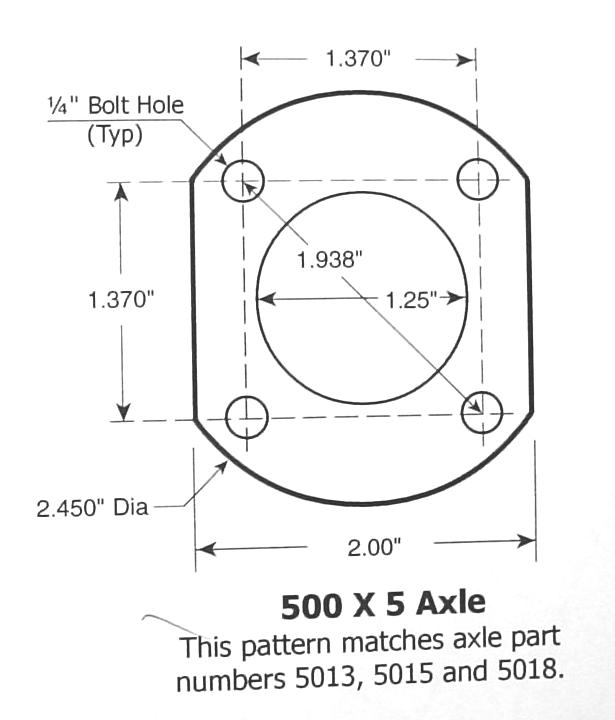

I am trying to buy a couple of axle drilling guides to suit the GAC 5018 axle but I am unable to contact kobush welding and machining via the email.
They ask you to contact them before ordering if you are outside the states.
I am in Australia. Can anyone help me with this, is there another supplier.

Just take this to a machine shop and have them make it up from 3/4" to 1" thick steel. It shouldn't cost to much.
Made one up myself right from this picture. I omitted the 1.25" center hole, made it 3/8", and it worked out just fine.
