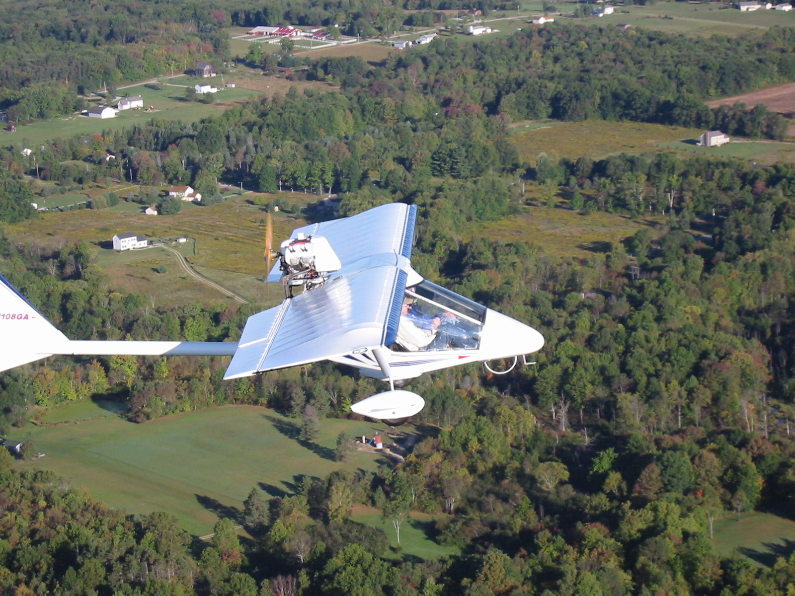

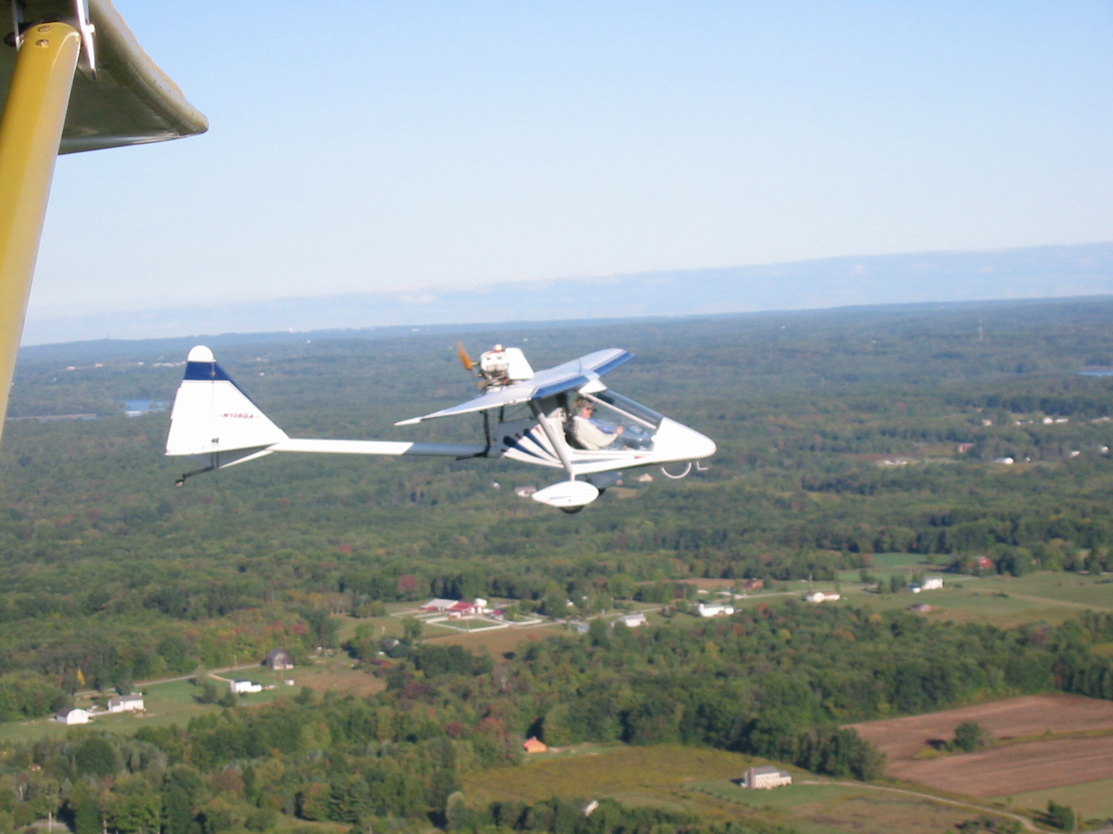

Things are quiet here are they not?Here are a couple picts of the last fly-in at CGS' former home field.Don James of JBM industries took these .Thom, are your VG's placed further back than these on my MK-3?

Gary,
Great photos of your Kolb, and I can see your VGs very well but can't measure their location in the photo Smile.
Mine are located with the top most part of the VG (aft end) at 6.5" aft of the leading edge as measured parallel to the lower surface of the wing. This means the aft end of the VG is 8.5" from the center of the leading edge tube as measured along the upper surface of the wing with a flexible tape.
I sure like your Jabiru engine fairing.... how much you want for it? If you don't want to sell it, maybe some day if you take your airplane out of service for a couple weeks, I can borrow it from you to copy.
