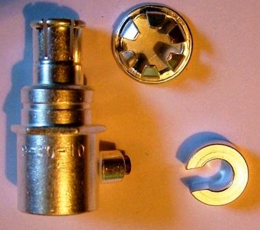

At 02:01 AM 9/20/2009, you wrote:
--> AeroElectric-List message posted by: "Thruster87" <alania(at)optusnet.com.au>
Where can I get the connector that fits onto the mounting tray [fixed onto the tray with a circlip] between the KT 76A transponder BNC and the aerial BNC connector [joins these two].Any part numbers???? Cheers
This puppy has been around for many years. The tray
side is a Ted 9-30-10. There's a number of them on
Ebay right now.
[img]cid:7.1.0.9.0.20090920195523.01d84108(at)aeroelectric.com.0[/img]

PostPosted: Sun Sep 20, 2009 5:06 pm    Post subject: Fixed connector on the Transponder Mounting Tray Reply with quote
I forgot that I'd fielded this question
some time back and posted pictures at:
http://www.aeroelectric.com/Pictures/Connectors/Coax/

How does a BNC connector hook up with these connectors, like the end on a TED aerial???
PostPosted: Mon Sep 21, 2009 6:26 am    Post subject: Fixed connector on the Transponder Mounting Tray Reply with quote
on a TED aerial???
These connectors accept a prepared end of the antenna's
feed-line coax. They are solder joints for both the
center conductor and shield.
If you want to break that feedline with a connector
adjacent to the radio, then the segment that comes
off the slip-connector is simply shortened to a pigtail
of the desired length which is then terminated in a
cable-female . . .
http://www.aeroelectric.com/Pictures/Connectors/Coax/BNC_Cable_Female_2.jpg
