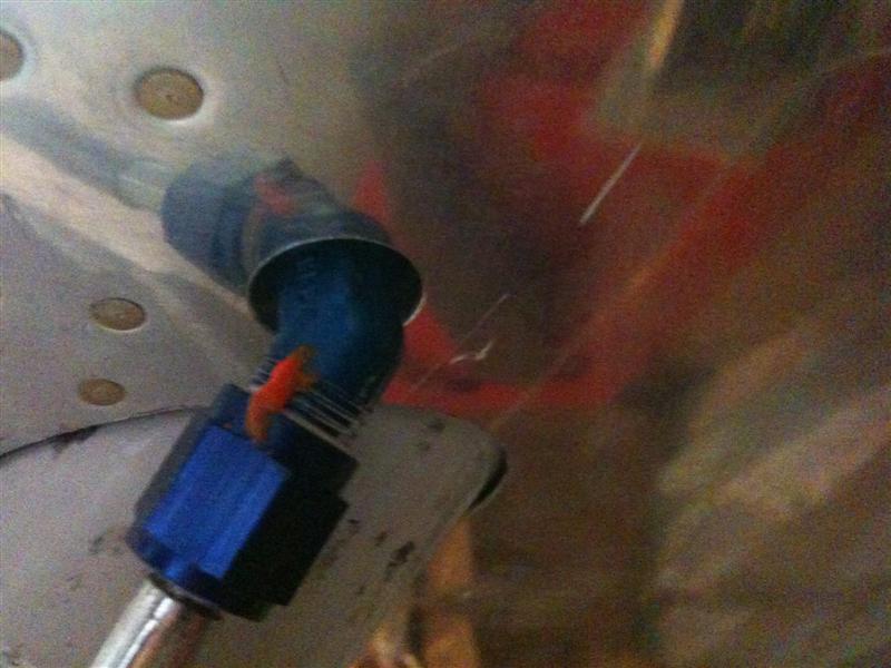

Phil,
Took a (crappy) picture of my brake line exit. The fitting mounts to the landing gear bracket and just goes through the skin.
Hopefully someone has a good idea for a fix. It ain't fun to take the landing gear bracket out.
Lenny

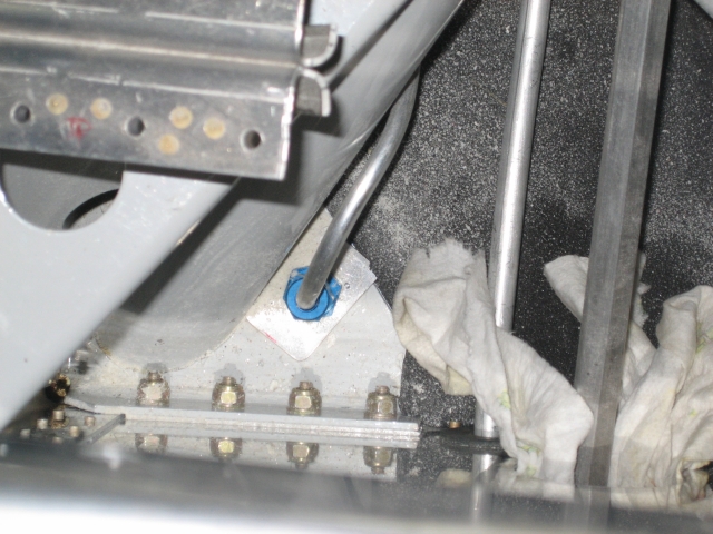

PostPosted: Sun Sep 20, 2009 1:19 pm    Post subject: Re: Brake line exit holes Reply with quote
Phil: We Phil's can hang together, as we make the same mistakes. Look at the photo attached, which shows how I put a small piece of .035 or .041 with the correct smaller hole in it, on top of the gear leg flange, put the fitting thru, and 'twas fixed. the slightly oversize hole in that flange won't cause a problem.
Can't recall whether there is a washer on the underside or not, but the fitting is solidly attached to the plane now.
Phil White
