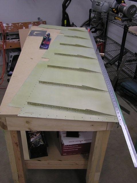

Pix 44 shows how I ensured that the trailing edge wedge was glued securely
to the rudder skin (step 1 page 7-9 of the plans). I reversed one wedge on
top of the wedge to be glued - this gave a flat surface to cleco. To ensure
the wedge was straight and flat, I then held both wedges in place with some
scrap aluminum angle that was clecoed to every hole in the skin.

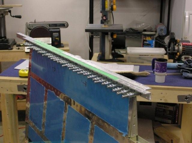

Pix 39 shows it all clecoed from below).

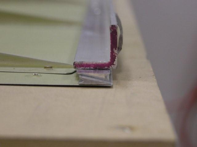

Pix 201 shows (end on) shows how I clecoed another piece of angle to the
other side when it came time to glue the other side of the rudder on. The
angle ensured that the rudder was glued perfectly straight without any
bowing.

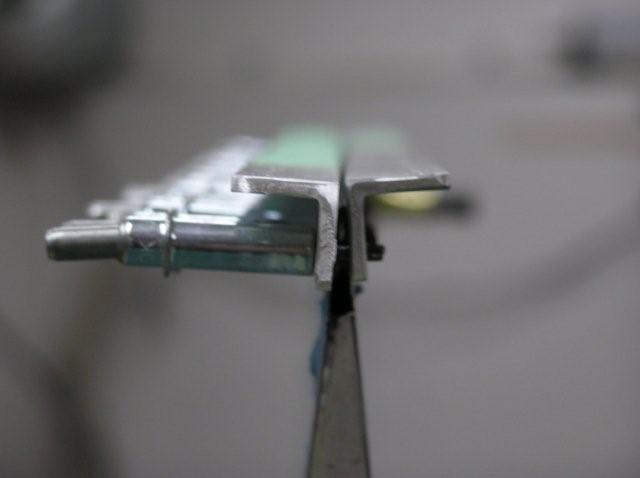

Pix 199 shows an elevator trailing edge all clecoed while the glue was
curing.
After the glue cured, I back riveted the trailing edge as per the plans. In
my case didn't bother alternating the rivets as the trailing edges were all
glued straight.
