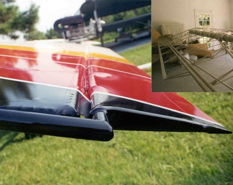

It's the drooped wing tips - I took off the ailerons
last time I did a major rehab.

I thought they changed the ailerons to the shorter ones on the
Firestar anyway?
I don't have any real good pictures of the "barn door" ailerons on my
old Firestar
except for these. They were tough to push at cruse speed.
My new (if 10 years old is new) thing has shorter, tapered ailerons
from (10 inches down to 8 inches? I forget))
They work a lot better & faster. I still have plenty of control a
slow/landing speeds.
VG's help a lot.

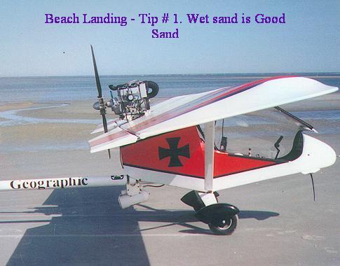

What is the " Geographic " on the tail boom ? The new plane looks real nice, I like the little changes you made. Do you think the sharp trailing edges lighten the control forces from the standard round tube trailing edges we have ?

I would imagine a sharp trailing edge would only reduce drag and look better

As far a the sharp trailing edges, they are standard GA stuff from AircraftSpruce.
I just think they look cleaner than "Homer's" bumps. (Not there's anything
wrong with the bumps
) I don't think the edges do anything to the control forces,
just "cosmetic" like I said before "so I could fit in with the crowd".
As you probably know, you can put "Graphics" on the boom
tube fairly cheap.This sounds stupid at first, but I used to
have "National Geographic[/b]" - in big black letters - on my old Firestar's boom
tube - just to keep the shrimp boats and others from calling the FAA every
time we landed on a sand bar or other questionable LZs. Read that
"Just to keep me out of trouble" and it's probably illegal, immoral or
"somebody's having too much fun - so I should call the cops".
