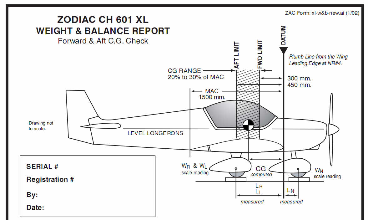

You raise an interesting point. The situation is bit more complex than a
simple reduction in CG range. A year ago, I found a W&B data sheet on
zenithair.com, called wb-xl-new.pdf, with the date 1/02 on it. I can no
longer find that document on the site. Of course that doesn't mean it's not
there. There's lots of stuff that I can't find on that site.
The 1st attached jpg shows a figure from that pdf.

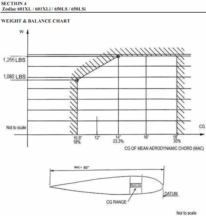

Within that past year, I found an AMD POH dated 12/05 on the net which
contained that same diagram, see 2nd attach.
Those CG ranges are rectangles 20 to 30% of MAC.

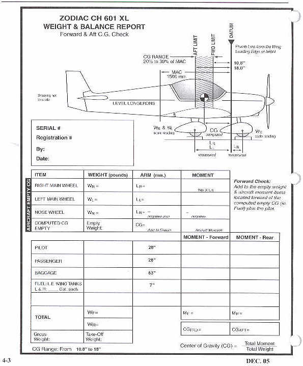

The AMD POH that was referenced in Zodiac Update of 7/27/09, contains the
diagram shown in the 3rd attachment. I presume that shows the reduction you
are referring to. Looking at the front of the range, one can see that it
now extends forward of the former 20% (12 inch) envelope. But at a reduced
take-off weight. The reduced take off weight also applies between 12" and 14".
