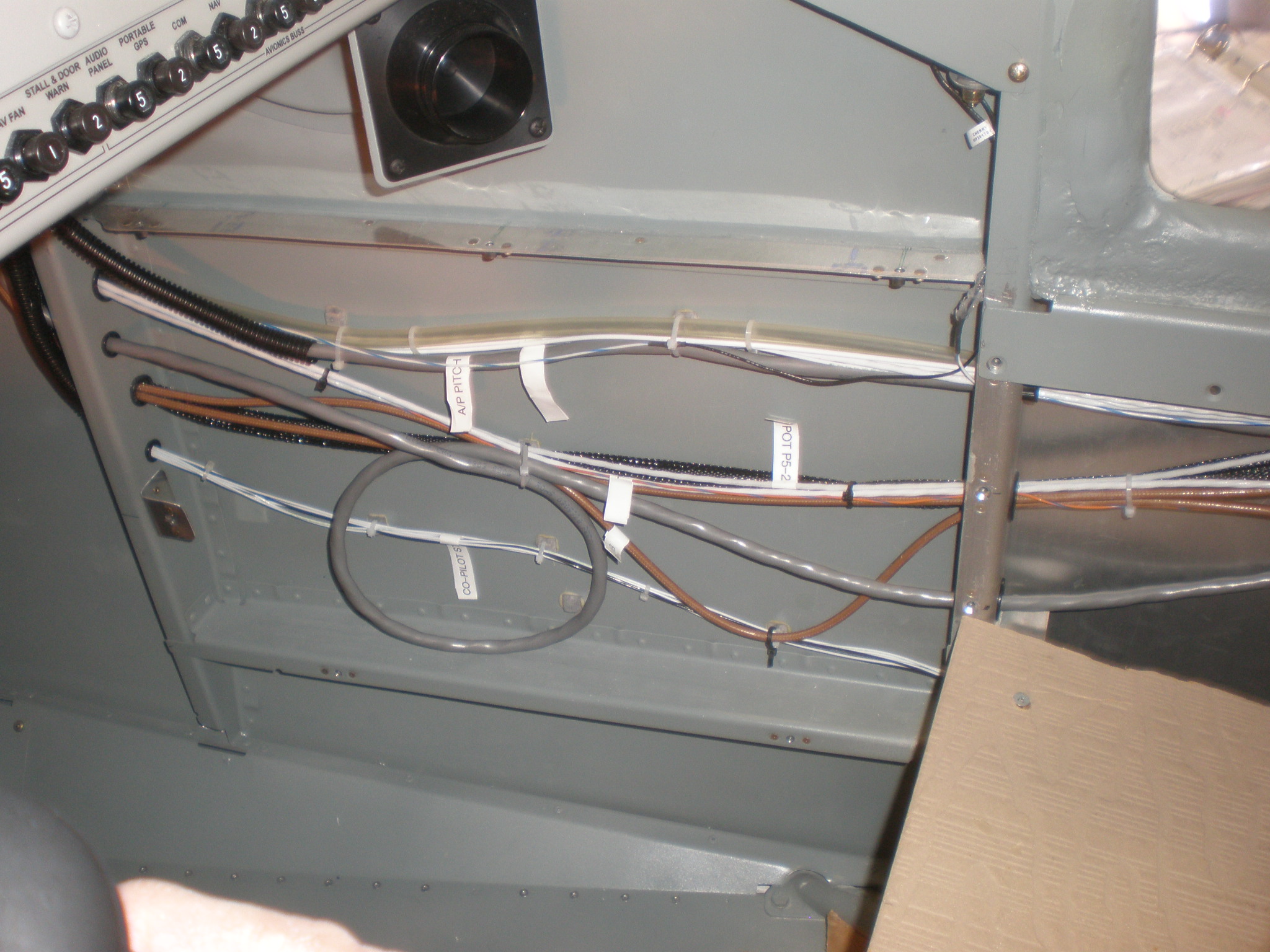

Wiring runs are a big deal as is the static line run going from the rear to the panel. Van's pre-wire kit is a pretty good purchase at this point or at least install the #2 wire from the battery/s to the firewall. I also like the idea of installing the static line. Installed a few of the Van's conduits from the rear to the panel area. Put some pull tapes in the conduit to pull thru future wires. Remember the stuff that is in the aft area like the AHARS or Magnetometer, battery, Strobe system controller, aft strobes and antenna wires for Nav, and Com. Do not worry too much as your conduit will help if you forget anything.
I also like the idea of an inspection port for the boarding step (see prior post) or to just nut plate the rear panels.

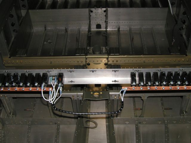

If you decide to roll your own electrical system, you might consider the following guidelines
(1) standardize on a limited number of wire sizes,; this will result in some wires carrying less than they could but will simplify your purchase of pieces in larger quantities. For example everyone is going to need about 20-25 ft of 002 gauge wire for the runs from the starting battery(ies). Other gauges can be purchased in 100 -500 ft lengths. I used 002, 8 14, 20, shielded 22 in triplets or quads.
(2) I chose to run DC down the left side of the aircraft and digital data down the right; obviously there were some exceptions due to location of the devices.
(3) For current or future use , both a primary and essential bus should be planned. B&C specialty provides power diodes for separation.
(4) For simplicity, each appliance can be controlled by a pull able or toggle breaker. Its a little more expensive but putting multiple devices per breaker and introducing additional switches limits flexibility and increase complication. It also makes troubleshooting more strait forward.
(5) Buy/borrow the necessary tools and buy the quality and quantity of terminals, butt connectors , dsub pins, etc.
(6) when using connectors and multiple shielded wires, triplets for example, document the use of each colored wire in each set of triplets.

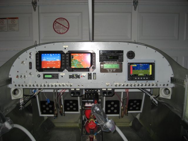

(7) I have attached a picture of my primary and essential buses with connecting 35A toggle breaker and power diode.

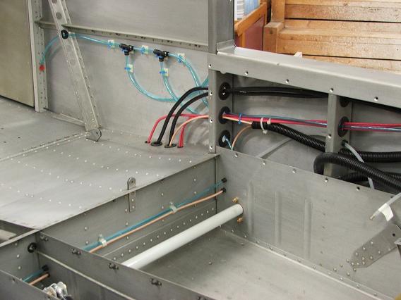

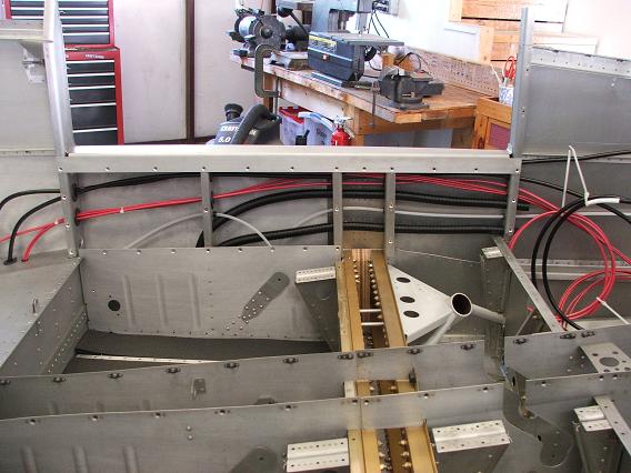

Here are a couple photos to show what I said earlier. The blue tubing is for oxygen. Bulkhead fittings are used for plug-in points. The bottle sits on the baggage compartment floor and connects with its own bulkhead fitting. The bottle is portable for ease of filling and for use in the 6.
Separate your wires to minimize interference and run them where ever you need to.

On the wire runs, is everyone sticking with the standard 3/4" holes on
each side?
If they can be enlarged, how much? If you can add some holes below,
what size?
Phil
nukeflyboy
Joined: 05 Jan 2008
Posts: 162
Location: Granbury, TX
PostPosted: Tue Sep 15, 2009 6:02 pm    Post subject: Re: Planning Questions Reply with quote
Phil,
These holes are too big to enlarge and in an awkward location. Use what is there: get a good fitting rubber grommet to protect the wires then start filling them up. If you run out of space, drill another hole. Don't sweat it at this point. Everyone's distribution will be somewhat different so don't try to copy exactly.
Dave Moore
RV-6 built and sold
RV-10 built and flying
Jim Berry
Posts: 237
Location: Denver
PostPosted: Tue Sep 15, 2009 7:39 pm    Post subject: Re: Planning Questions Reply with quote
Phil,
I asked Van's about enlarging the side holes, and they said up to 1" would be OK. I used a Greenlee punch from the electrical dept. of Home Depot.
Jim Berry
40482
