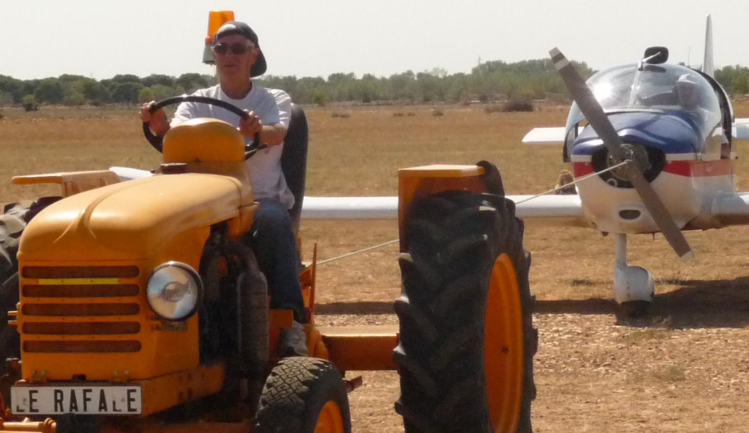

A French friend of mine was towing a glider when he got problem and had to land. Here is a photo where is is pulled to the hangar by a tractor. Why? Look carefully at the propeller. One blade is about ten centimeters shorter!
Being himself a glider pilot, Yves had no problem with a dead-stick landing; they were climbing right above the airfield. But ... how can a propeller just loose ten centimeters? I don't understand how it can happen. Split in two, yes. A blade coming entirely looose, yes. But ... loose one end?

two words. Manufacturing defect.

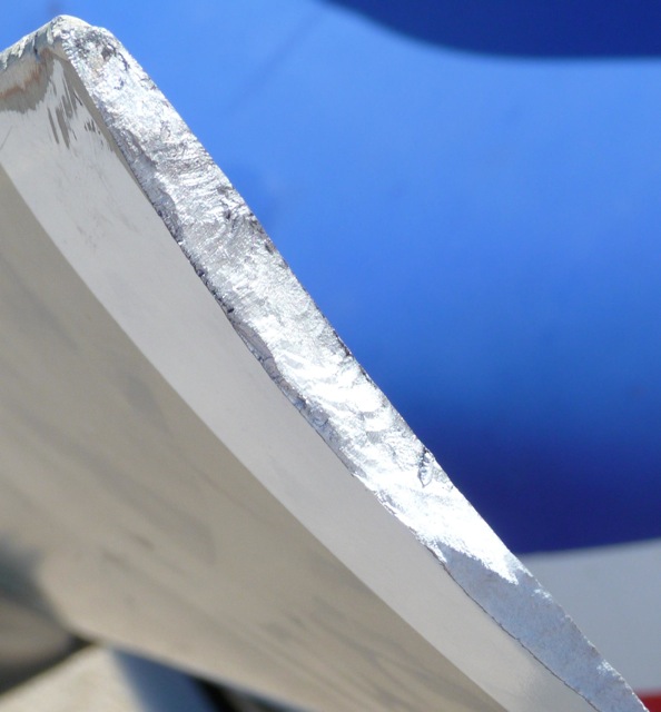

I noticed that it appears to have separated exactly at the paint line, could
it have been scored at that point? I also notice the pilot is still wearing
his headset, which I find amusing.

Undressed blade nicks in metal props cause stress risers that can create a crack which can progress across the blade like the one shown in the photo. Most of us with Kitfoxes use wood or composite blades that don't crack laterally like metal props. Gouges in metal props must be dressed out before being flown again but often aren't. A gouge that occurs after preflight may not be noticed until it's too late. Certain locations along the length of a propeller are more susceptible to cracks due to standing waves induced by engine vibration. Tachometers on some aircraft have a red arc (below the red-line) indicating where the engine is not to be operated for extended periods due to harmonic or resonant vibration that may lead to structural failure of the airframe or propeller (refer to "Aircraft Systems" by David A. Lombardo, p. 103).
Yes, isn't it strange? Here is a close-up photo that shows better how it follows the paint line.

Looks like the leading edge is beat up pretty good, and there is some discoloration on the back side of the prop that suggests that there was a discontinuity open to the surface for awhile. There are also some pores on the front side of the blade that look as if it could be porosity. Kind of hard to tell from the pic, but I would say there are some manufacturing issues, as well as some bad dings on the leading edge that should have been dressed up with a file long before the tip departed. Aluminum is funny especially if used in sand or rain. The smallest nick in the blade will open right up if you are hitting lots of rain or the spray from floats. Water, once allowed to get into the open grain of the metal will eat it up QUICK. I know guys that keep a nice flat pretty smooth rock in their pocket just for dressing up blade nicks on the props of their float planes. The old times swear that if you don't keep it smooth, the water will eat they prop in VERY short order.

looks like the leading edge of the prop was kind of dinged up.  Paint is wore off also.  Just my uneducated guess C but I think a crack started from a nick on the leading edge.  Take care C Jim Chuk  Avids C Kitfox  Mn.

Michael, good pic of the failure area. In my work as a TSB Canada investigator I see a fair number of component failures. I agree that the blade had a crack from its trailing edge, as evidenced by the dark area which is actually oxidation. The bright area is the final fracture and judging by the leading edge it was probably a nick of some sort which propagated into a crack and then overstress failure fairly rapidly. The trailing edge crack should have been noticeable however during a pre-flight inspection.
