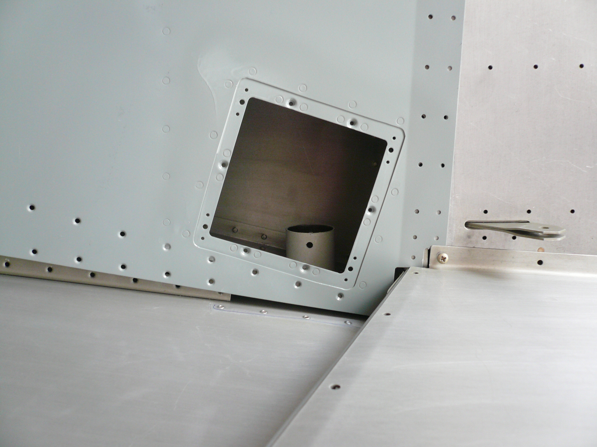

PostPosted: Thu Sep 10, 2009 5:44 pm    Post subject: QB Fuse Question Reply with quote
I did not remove the front floor boards either, but worry that there might be some stuff down there. If I were building over again, I would nut plate the rear floorboards for inspection/maintenance and smuggling drugs.
Seriously though, at the very least I would install a maintenance plate over the boarding step bolts. (I did do that)
Inspection plate for step
 Filesize:  1.48 MB
 Viewed:  12490 Time(s)
