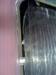

As you may know, I attempted to install my left side door window last
week with somewhat disastrous results. As best I can tell, my shop
was too hot (about 85 degrees) and the Weld-on 10 set up too quickly.
The bond to the fiberglass was perfect, but I had voids between the
window and the dried Weld-on 10 in over half of the bonding area. I
had also failed to remove the masking tape from the inside of the
window soon enough and had a fair amount of masking tape trapped by
the Weld-on bead. In the picture below, the whiter area is where the
window did not bond:

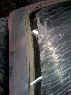

This edge, though not perfect, is more like what the bond should look
like:

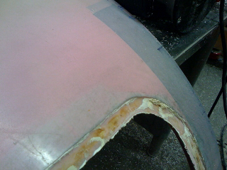

With that, Jeff suggested I route it out with an Onsrud carbide double
flute 1/2" x 1/2" bit (I wound up using a similar bit I had in my
router and it worked well), I said good bye and ponied up the $150 to
Vans for another window. Here's what the door looked like after the
window was routed out (but before I sanded it clean):
