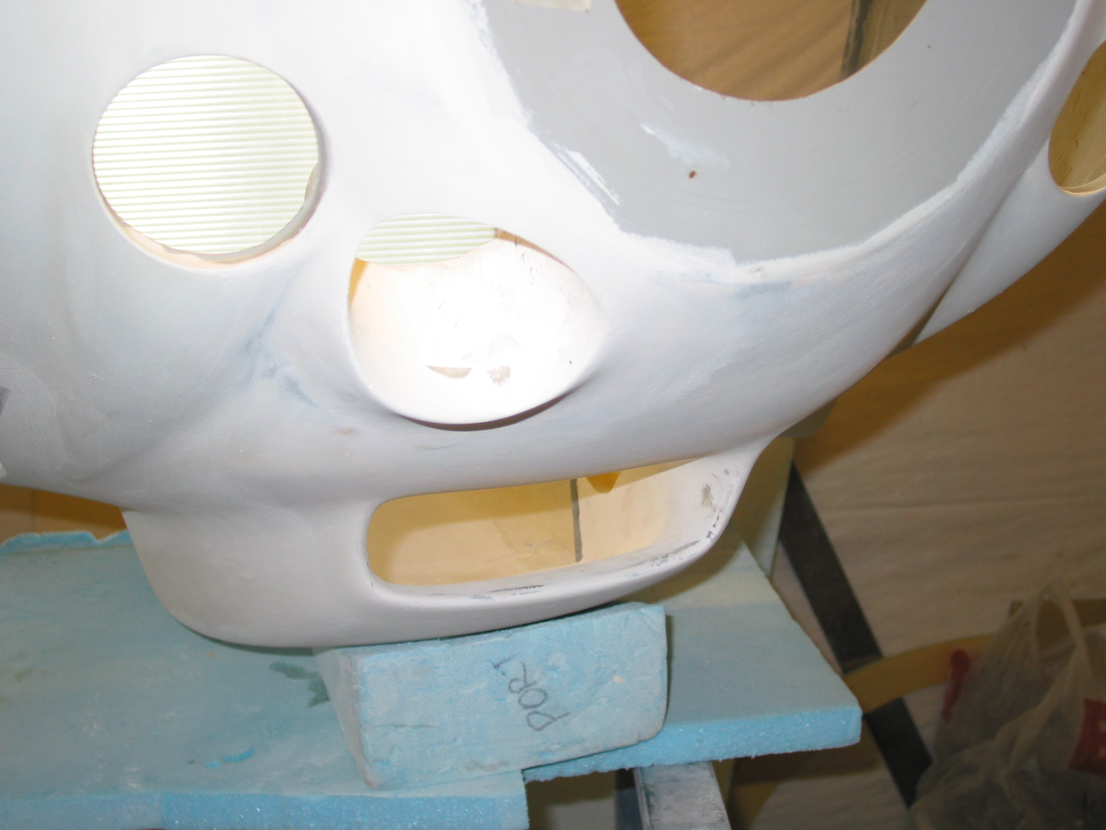

PostPosted: Thu Sep 10, 2009 1:16 pm    Post subject: Congrats to Jeff,Cooling feedback for Bud Reply with quote
The only comparable data that I have was as follows:
20 minute ground at between 2500 and 4000rpm, CHT stabilised at 94C, OAT 12C.
If adjusted for a 30C OAT, then CHT would be 116C.
At 2500rpm, oil temp was cooling down through 109C, or 127C adjusted to 30C.
There was a moderate wind from behind and <1 hour on the engine, so still tight.
Cooling modified thus:
Duncan McF.
