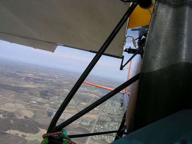

Hello all....I took another video out the back with the doors and windows off and this is what I got. The video is not the best ,but it doesn't seem that bad...looks worse on the ground that in the air...
Anyway...for what it's worth....
http://www.youtube.com/watch?v=LU-Hr6HigcQ

PostPosted: Mon Sep 07, 2009 5:55 pm    Post subject: Tail shaking Reply with quote
is what I got.
chris ambrose
Chris A/Gang:
The 6" tail boom is a very flexible tube.
Most of the prop blast is hitting the side of the tail section.
Prop blast knocks it one way and relative wind is pushing it back.
Amazing how stable the tail section is considering the environment it lives.

PostPosted: Tue Sep 08, 2009 5:48 am    Post subject: Re: Tail shaking Reply with quote
chris ambrose
M3X/Jab 60+hrs
N327CS
Based on your video, the tail is going to get way more abuse on the ground taxiing than in the air. I am adding a "Hauck tailwheel brace" to mine and not worrying about it.
