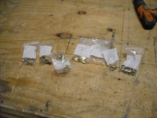

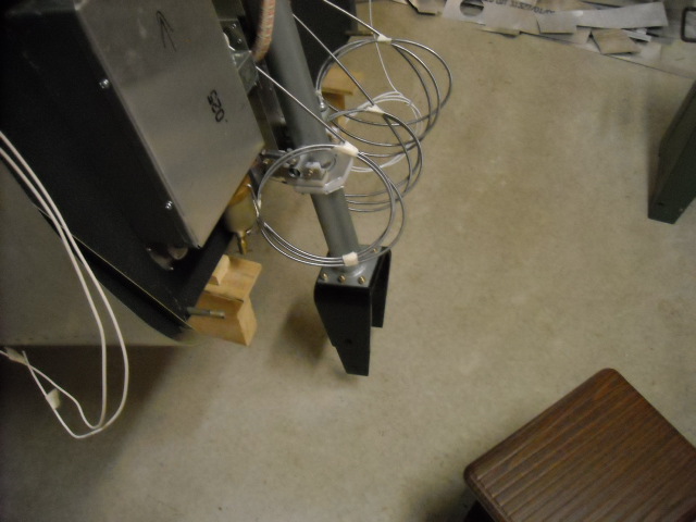

I wound up with a PILE of AN-5 and AN-6 bolts that aren't called out
anywhere on the plans. I finally found 18 sets of AN-4-5 that worked quite
well. Nose gear is complete; carving out the right main at the moment. Had
to use a cutoff wheel in my circular saw to cut the 1/4" aluminum to size.
Looks like I'll have to jack the cradle up to install the wheels and brakes
when the time comes.
Bill

PostPosted: Sat Sep 05, 2009 3:51 pm    Post subject: HD/HDS Gear Question Reply with quote
All-
I thought I was corresponding directly with Larry, but I guess not.
This was the most deceiving picture I've ever taken. When I looked at
it, I thought "Oh my God, I put the fork in backward, and the two pieces
separated". All parallax. If I took a picture 90 degrees to the side, it
would look just like the print.
Bill
