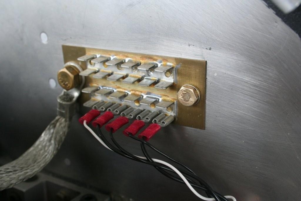

I’m in the process of trying to layout my electrical system on paper and in my head.
Probably the best place to start is with the grounding system. I really don’t like the idea of routing current through the airframe and would prefer to ground everything back to a block.
Here is where I think I’m headed.
<![if !supportLists]>1) <![endif]>Run a line directly from the (-) Terminal of the battery forward to the firewall.
<![if !supportLists]>a. <![endif]>Attach this line to a “Forest of Tab” on the interior side of the firewall. Ground everything forward of the baggage compartment to this spot.
<![if !supportLists]>b. <![endif]>Jump through the firewall on the other side and ground all FWF items to the “Forest of Tab” on the FWF side.
<![if !supportLists]>c. <![endif]>I’ll also ground the crank case at this point too.
<![if !supportLists]>2) <![endif]>Run a line directly from the (-) Terminal of the battery to the left wing tip and install a Forest out there too…..
<![if !supportLists]>a. <![endif]>Install a similar setup for NAV, Strobe, Taxi/Landing, Pitot heat, Aileron Trim, Stall Warning, etc……
<![if !supportLists]>3) <![endif]>Run a line directly from the (-) Terminal of the battery to the right wing tip and install a Forest.
<![if !supportLists]>a. <![endif]>Repeat the left side setup of grounding on the wing items on the right side.
<![if !supportLists]>4) <![endif]>Run a line directly from the (-) Terminal of the battery to a “Forest of Tabs” located beside the battery box.
<![if !supportLists]>a. <![endif]>This is for the point for grounding all tailcone electronics. NAV, Rudder Trim Servo, Elevator Servo, and any other electronic devices that end up aft of the baggage compartment.
How have you designed your grounding system? Grounding issues can be a pain to chase down, so that’s the reason I’m really wanting to spend the time designing a system that is pretty robust and easy to trace.
in my head.
1) Run a line directly from the (-) Terminal of the battery forward
to the firewall.
a. Attach this line to a “Forest of Tab” on the interior side of
this spot.
My only comment would be to mount the 'forest of tabs' on the sub-panel
where it's access is better than the firewall. You never know when
you'll add something!
b. Jump through the firewall on the other side and ground all FWF
c. I’ll also ground the crank case at this point too.
2) Run a line directly from the (-) Terminal of the battery to the
a. Install a similar setup for NAV, Strobe, Taxi/Landing, Pitot
3) Run a line directly from the (-) Terminal of the battery to the
a. Repeat the left side setup of grounding on the wing items on
the right side.
4) Run a line directly from the (-) Terminal of the battery to a
a. This is for the point for grounding all tailcone electronics.
I can't really find anything 'wrong' with doing things this way with the
exception of electronic AHRS and Compass mounted back there. They
should have a ground wire going back to the ground point of your
electronics. The ground potential COULD be different and cause
problems, but for strobes and lamps etc. I see no reason not to use a
forest of tabs here.

Phil,
Some thoughts:
<![if !supportLists]>1. <![endif]> The only thing on the engine that needs a hefty ground is the starter. Run your ground wire from the same bolt that goes through the firewall to the nice ground lug on the starter (a number #4 wire works well). On the same starter ground lug do a jumper (like a ground strap or perhaps a piece of #6 wire) to the mounting bolts on the alternator. This way you have an excellent ground path for both the starter and the alternator.
<![if !supportLists]>2. <![endif]>I plan on two Odyssey PC625 batteries in my RV-10 (that is what I’m running in my 8A). These will be enable split bus operation in the event of a failure of one side or the other. If you plan on split power supplies, keep in mind a single ground wire that connect both battery grounds to a single point defeats the purpose of having redundant power supplies. Run a single common #2 or #4 wire that connects both battery grounds to the firewall bolt discussed above (this is the starter ground and half of the panel ground). Run another #10 wire ground from both batteries to another “forest of tabs” on the firewall. Split the panel ground paths between them consistent with how you are splitting the power distribution. The objective is to not allow a single failure point (the firewall ground lug) take down your entire panel.
<![if !supportLists]>3. <![endif]>Typically a single #14 ground wire is sufficient as a common ground for each wing. You may want to run another #14 ground to the pitot heat if it draws a lot of current. Ground these on the same firewall lug that you have the starter on (on the cabin side). You don’t need a forest of tabs in the wing, just solder pigtails onto the single #14 wire that go to each component. Do the same type of pigtail for all tail cone grounds.

I think I see what you’re saying Carl.
You’re basically suggesting that I ground everything to the forest of tabs behind the panel, but make a heavier run to each wingtip and ground to those. Basically a start topology… Right?

Have a dedicated ground for all your radio/gps equipment and ground
everything including the headset jacks back to this point. Make sure
that you use the washer with shoulder (comes with the jacks) to
isolate the headset jacks from the airframe ground.

PostPosted: Tue Sep 01, 2009 10:12 am    Post subject: Grounding Questions Reply with quote
Phil,
For FWF a single braided connection from the rear of the engine block to a
forest of tabs on the firewall is more than sufficient (pic attached). You
would only be adding unnecessary weight with a ground connection all the way
up the starter and alternator.
Brian

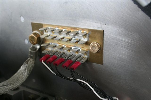

rv10builder(at)bellsouth.
PostPosted: Tue Sep 01, 2009 10:23 am    Post subject: Grounding Questions Reply with quote
Phil,
Brian
N104BS (160 hours)
 Filesize:  223.89 KB
 Viewed:  6364 Time(s)
Phil,
Brian
N104BS (160 hours)

PostPosted: Tue Sep 01, 2009 12:25 pm    Post subject: Grounding Questions Reply with quote
Thanks Brian...
What did you run from the battery to cabin-side of the firewall?
Also, do you have all of your grounds coming back to the tabs?
AKA: Wingtips and Tailcone too.
Thanks!

Brian wrote:
> Phil,
> to a
> attached). You
> the way
> Brian
> N104BS (160 hours)

Phil,
There are two issues. Yes, the engine needs a very stout ground cable to
the firewall, because the engine mounts make a poor grounding path. No,
you don't need a ground cable from your firewall ground point to the
battery. The airframe will serve very well. Just for example, my Mooney
has a braided ground from the engine crankcase to the firewall...no
forest of tabs, just a single bolt and washer connection at firewall.
ALL grounds are to the airframe. Not as good as the single point of
grounding for electronics. But more than sufficient for all your
lighting and your starter. My battery is behind baggage compartment,
just like RV-10. Ground is to an airframe rib with bolt and washer.
Carries all 300 amps or so during starting, with very little resistance.
Virtually all certificated metal skinned aircraft do the same, because
it works, is lightweight and maintenance free. Including the Piper
Cherokee he mentions reducing battery size. Other than that mention,
none of his verbiage really addresses the rear mount battery in a metal
airframe. He mostly talks about batteries on the firewall and composite
aircraft. Yes, you would run a cable from battery to firewall if it is
only 18". The subject has come up on his email list.
But you are free to install the extra heavy #4 cable all the way back to
your battery if you want. Just money, weight and space.
