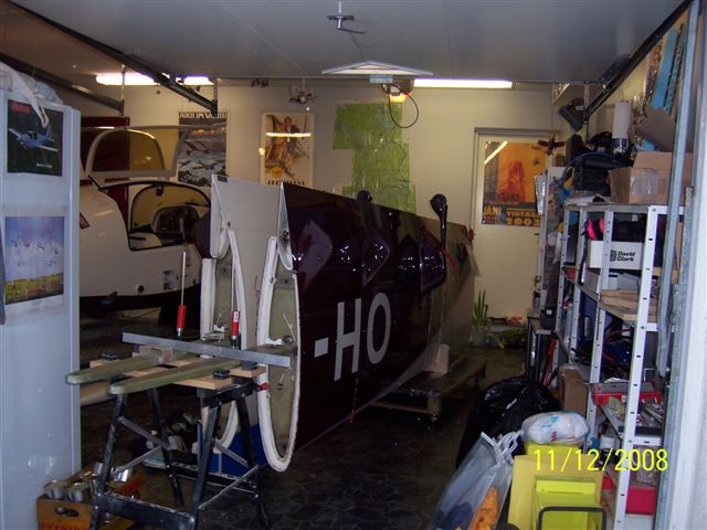

PostPosted: Sun Aug 30, 2009 11:27 am    Post subject: Trailer Length Reply with quote
Phil
You will be happy if your garages´s free lenght is 7 metres or more.
So you are able to circle your XS easily.
I have only 6 metres and so I have to locate the trailer with OH-XRT (XS) a little bit diagonally.
Doors´ openings (twin garage) are 2,44 m wide and free height is only 2,15 m.
I would love to have more space - it is very easy to broke for example fin strobo or especially plane´s gull wing doors if forget them to be open position. The prop blades (three blades) must point to "2", "6" and "10" when moving the trailer in or out.
Raimo
