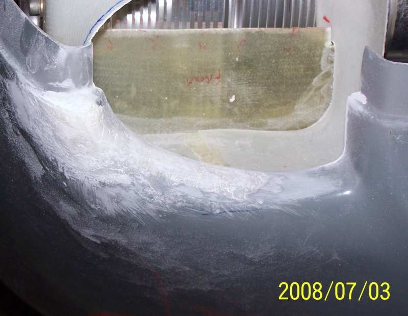

I think I had a similar problems with my cowl. I don't remember the details (heck, I barely remember what I had for lunch) but I found a good picture that might help you out.
After getting the crank shaft opening set up I had misalignment of the top and bottom fiberglass pieces that looked really awful. I decided to fill in the gaps with flox and epoxy filler. The flox came in a composite training kit from Aircraft Spruce. Flox is just a nice pile of chopped up fiber (cotton, I think). The kit was a great purchase even though intended for Rutan builders and their special techniques. I haven't yet flown my plane, but I think the filler will hold up just fine as well as holding paint just as well as the rest of the cowl. Please see the pictures below.
Paul
XL awaiting engineering changes

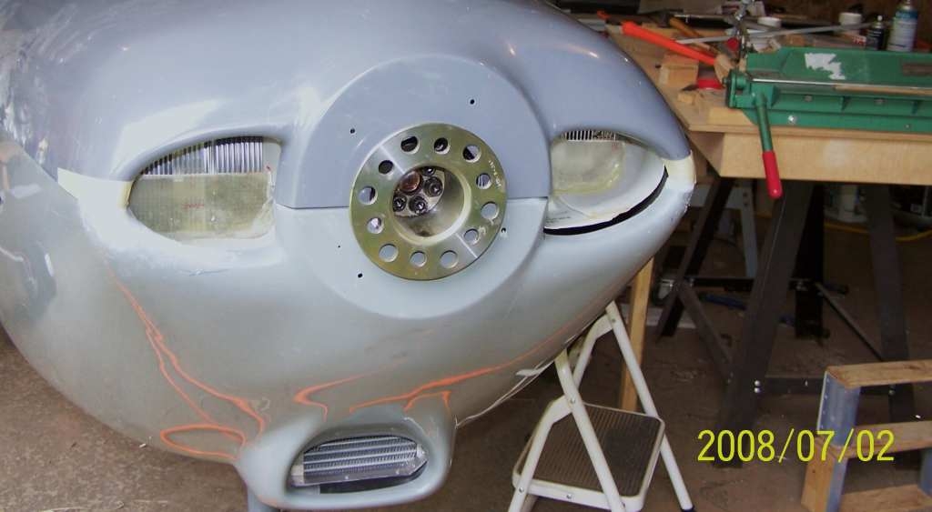

I'm trying to fit the cowl (601XL Jab 3300 with the Jab Cowl)
Look at the attached pictures When I get the thing lined up so the air intakes line up and are symmetrical the centering of the prop shaft is off.. WAY OFF Ok so which is it Center the prop and not center the air intakes?? (seem bad for cooling to me) or center the air intakes (and it looks like *&*^%^&*)
OK someone whos been here before guide me
Larry Whitlow

PostPosted: Sun Aug 30, 2009 10:24 pm    Post subject: Re: Cowl Fitting ( the stuff nightmares are made of) Reply with quote
I had a similar problem as well with the misalignment so I used a heat gun to twist/bend and tweak it.I'm very happy with the result and it was quick to do. Cheers
