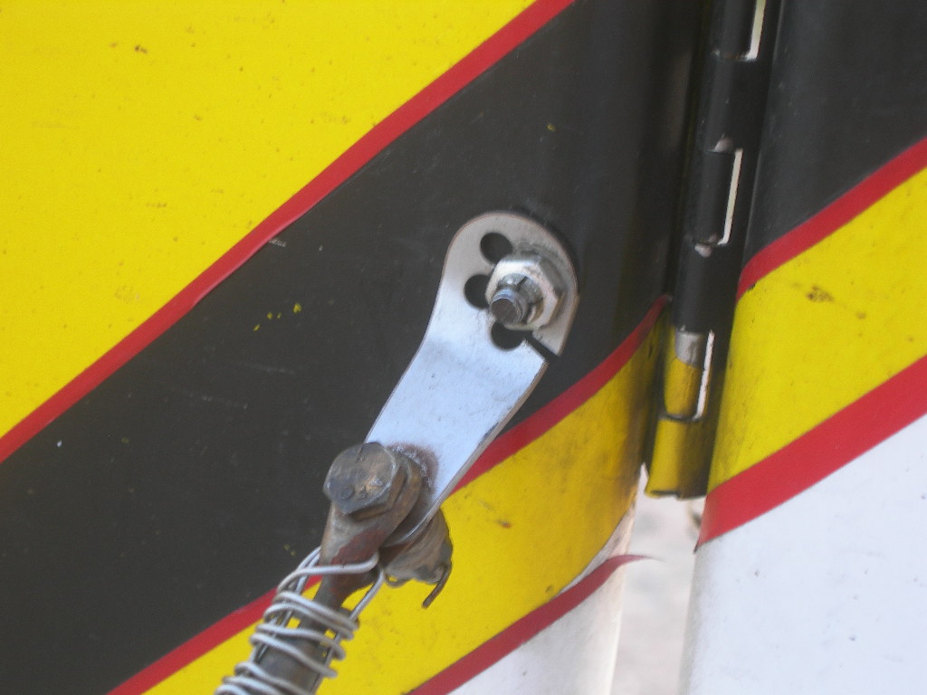

I found this cracked tailwire tang while doing my preflight this morning. It's the one on my left-side vertical tail. I happened to have a fresh new one on hand, so a little bend on the vice and 10 minutes of work and I was good to go.
Prior to this happening, I had been thinking of a possible better way to assemble the Kolb tailwires by copying what is done on a lot of other GA planes in our hanger. They use the solid rods, threaded on both ends, with fork attachments and jam nuts. They also have tangs, but they are thicker than ours. I think I've seen one on a Kolb somewhere, just can't remember whose it was. Seems that would be better, if you never fold/unfold your plane. I have always looked very closely at those tangs on my preflights, looking for signs of a stress crack forming, but I never saw any indications on this one until I found it in this condition this morning. It had to have happened yesterday while I was out flying, because it wasn't there yesterday morning.

Do you think that failure was caused by air loads or the amount of tension?

Why so many adjacent holes. I would think that would have something to do with the failure.

That is a good point. Although Kolb supplied the original kits with
the multi-hole tangs
because that was the only adjustment (aside from a small one possible
by twisting the cable)
In this case I would fab a plain steel tang with one hole because of
the turnbarrel. (sorry, had to call it by its real name)
good to go.

I don't like those multi-hole tangs, especially stainless steel, plus being
bent to fit.
Glad you caught that one.
I have never used that style.
I have used the SS tangs with one hole each end with good success.
My mkIII is equipped with 4130 tangs I made from strap and turn buckles to
adjust the tension.

My best guess would be vibration and a stress riser where the tang was bent across punched holes in SS. SS is much less stress resistant as 4130.
Jim's photo shows two bends in the tang.  One of those bends goes right through the hole that broke. If my old eyes are seeing correctly.
cherie/all
The tang with several holes was designed so as to be able to adjust the length of the cable for proper tension. By moving the bolt from one hole to another, it will either tighten or loosen the cable.
On the tangs with only one hole (at each end of course) they could be adjusted by installing or removing washers placed under the tang. My builders manual mentioned this and suggested installing at least one washer between the tang and the tail surface when being built so if adjustment was needed later it could be done as described.

It looks like the clevis end of the turnbuckle may have been pressing on the
tang as there appears to be an indented marking on the tang matching the
curvature of the clevis end. (Sometimes photos are deceiving, but it does
give this appearance.) I don't know if at some point in the life of the
airplane that when the wings were folded the turnbuckle was leveraging the
tang and flexed it ... possibly when folding the tail, the turnbuckle had
some pressure on it and in turn flexed the tang?
I know the tang is not 4130 and there are holes in it - but even still there
is a lot of strength in the tang. I have a hard time thinking that the crack
resulted from tension loads alone.
The tang is designed to replace a turnbuckle and consequently most Kolbs
would not have the turnbuckle. So this is probably a relatively rare set-up
and possibly the turnbuckle and tail folding had something to do with it?
the
set-up

You may have something there. Would be easy to side load the tang with the
turnbuckle (turnbarrel for BB) during tail folding and handling.
I use four turnbuckles on my mkIII tail wires. Normally, I do not fold, but
if I do, all the wires come off the tail section first.
Looking at the photo, looks like there may be some scoring/scratching by
wrench or socket around the high temp lock nut in the area of the break.
Doesn't look like there is a washer under the nut either.
If the tail wires were loose in flight, would induce a lot of vibration to
the SS tang.
Another thought from my foggy old mind, the further the bend from the
attaching bolt, the more side load at the bolt. When I make up my tail wire
tangs, I bend them at the edge of the washer under the nut or bolt head to
reduce possibility of side load.

I agree it looks like a combination of the bend being too close to the holes and the weakness caused by the holes being close together that helped get the failure going.
To Dennis' reply, I have not to my knowledge ever folded up the tail causing the turnbarrel to leverage some tension on the tang, but it could have happened with a previous owner. I think the main thing to learn is, regardless of what caused it, the crack developed at the weakest point of the tang where the holes are all close together.
I'm going to locate some SS single hole tangs and wil be replacing the entire tail wire assembly.

Jimmy and others with turnbuckles (or barrels),
John mentioned that he was not aware of any such tang failure previously and
I have none either, these are not just used on Kolb, they are extensively in
all sorts of ultralight aircraft. So, logic would seem to indicate that the
that the presence of the turnbuckle is probably related to the failure in
some way.
The tang, I feel certain, is quite strong enough for its intended tensions
loading. So all this to say, make sure you don't replicate a scenario that
would not eliminate the real problem. Any tang will fail if flexed sideways
a sufficient number of times.

bottoms are really along for the ride - the tops carry the downward force on
the horizontal stabilizers. If the top wire support fails, you probably
will not make it home. So keep the failure modes for the top wires as few
as possible. The turnbuckle itself represents several failure modes: (1)
whatever happened to yours (2) the turnbuckle could fail itself (3) there is
an additional connection points/links to come apart(4) the safety wire could
fail if incorrectly done or forgotten (5) the turnbuckle could be
incorrectly assembled with too few threads inserted. These are all
potential failure modes - most not likely - but how likely was your tang
failure when none has failed before?
(B) The upper wires are the longest and therefore subject to the most
in-flight vibration and movement in general and adding mass to these will
likely increase any in-flight vibrations, etc.
I can understand why someone would want them: its more traditional and it
makes adjustment easier. But given all the additional failure modes (and
things to check on preflight). I would not have the turnbuckles on my
airplane.
If you do include turnbuckles and fold your tail, you should consider,
having wire on both sides of the turnbuckle to eliminate any potential
binding, or (remove the bolts thru the stabilizer(s). If you remove the
bolt(s), putting it back may be a challenge - if you fold regularly you
probably don't want to do it this way.
Dennis
slyck(at)frontiernet.net
PostPosted: Mon Aug 31, 2009 5:53 am    Post subject: always do your preflight! Reply with quote
Thanks Dennis. Good points to consider. In addition we may want to
look at
the dinky little bolts that do the pass-through. The threads would
be the weak area. -both on the nut and the bolt.
Because of the angle they are in both tension and shear.
The loads on these wires are not great. Vibration and work-hardening
with hours of run time would be the real culprit.
BB
previously and
extensively in
that the
failure in
some way.
tensions
scenario that
sideways
I would not put the turnbuckle on the top wires for several reasons:
(A) These are the wires that will get you home when all else would
fail. The
force on
probably
as few
modes: (1)
there is
wire could
tang
these will
and it
modes (and
airplane.
remove the
you
Dennis
NeilsenRM(at)comcast.net
PostPosted: Mon Aug 31, 2009 6:53 am    Post subject: always do your preflight! Reply with quote
Jimmy / All
The turnbuckles add mass to those wires so that if there is any in-flight
vibrations or side loading it would compound the issue. Add to that the V
twin engine that was bolted solid to your engine mount would have added to
the issue by transmitting engine vibrations.
I would suggest you give your plane a very close going over to check for
other vibration related metal fatigue.
Rick Neilsen
Redrive VW Powered MKIIIC
