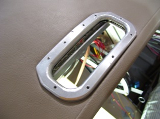

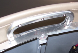

PostPosted: Sun Aug 30, 2009 6:01 am    Post subject: Grab Handles Reply with quote
Michael,
Attached are a couple of pictures that show the grab handle reinforcements I made for my plane. I took off the original doubler and copied it on the top out of .250 6061. I then bent it by hand to fit the contour of the cowl top. Once that was complete I made another "U" shaped piece that fit underneath. I then tapped the upper piece to accept 6-32 screws from the bottom. This was a couple of days worth of work but I enjoy whittling things out of aluminum.
Dave Hertner
#40164
