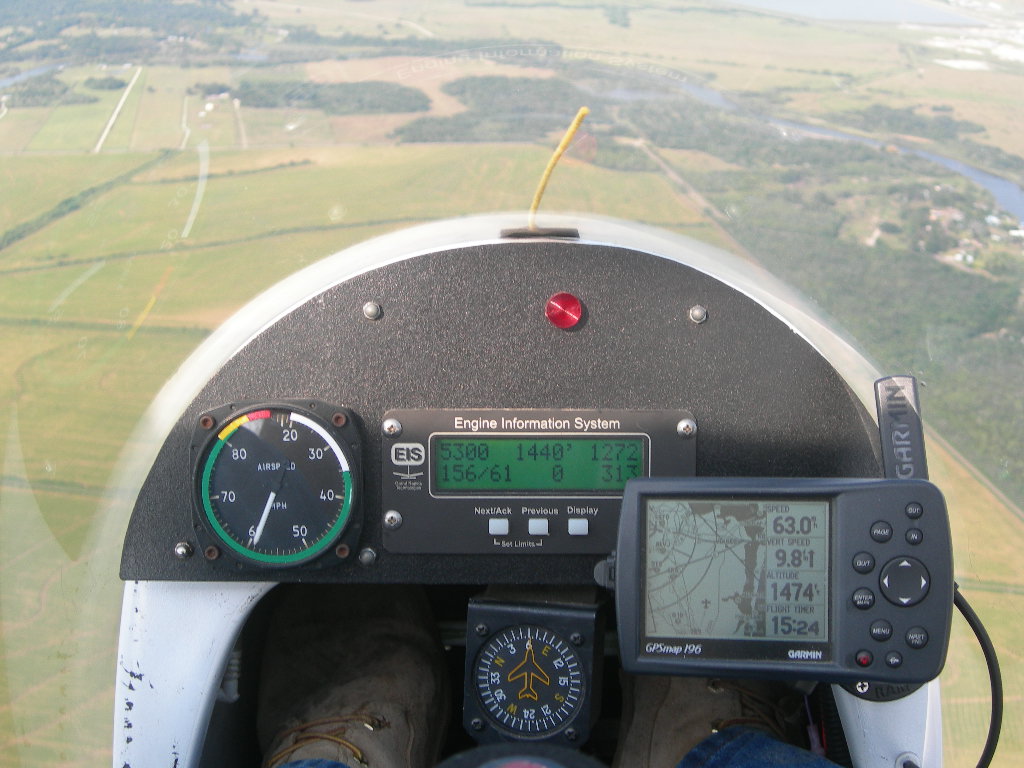

After pulling my wing, I found my U-joint castle nut was simply not tight enough. I locked it down, firm but still movable, put a new cotter pin in it, and all is good with both wings equally solid. Of course I had to go fly it. The only thing hard was pulling and re-installing the wing by myself without tearing anything up, but I've learned how to use carpet and barrels as cheap labor. I'm certain the slop has been in there since I got the plane 2 years ago, as I've never messed with either U-joint before other than pulling wings.
It was a great evening to fly, fairly light winds and only upper 80's due to some earlier T-storm activity. I took one pic, NW of Galveston and well-south of Houston.
Thanks for all the tips and advice -
Jimmy Y
 Filesize:  174.89 KB
 Viewed:  10491 Time(s)
