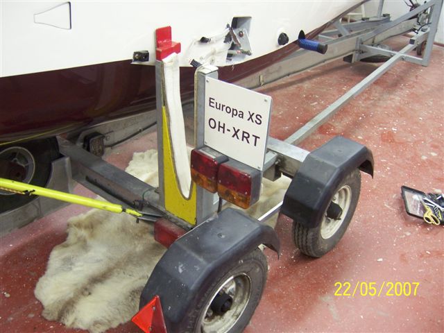

PostPosted: Thu Aug 27, 2009 7:14 am    Post subject: Trailer wing cradle Reply with quote
Sean,

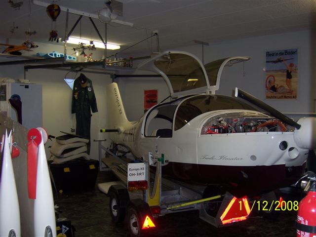

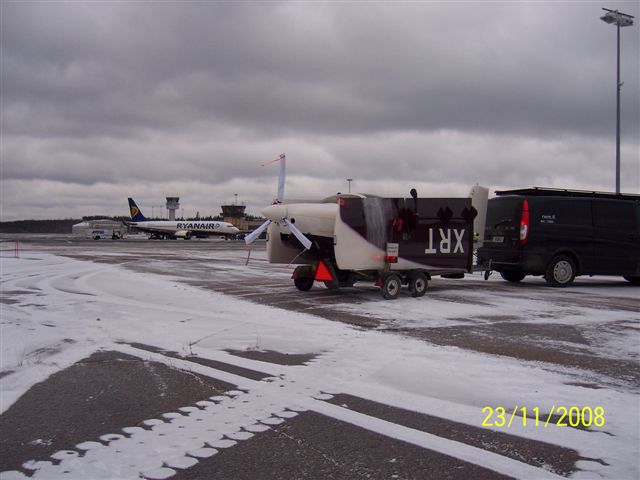

I replaced the rubber straps with solid massive wood. So the wings are almost fixed when in trailer. The shape of the wooden blocks is copied from the wings and they were covered by self adhesive carpet tape. What is important I wrap the wings (the section which is in the cradle) before loading them to the trailer by sling (kitchen?) film. That prevents very effective all the rubbing (check photo "Ryanair").

fklein(at)orcasonline.com
PostPosted: Thu Aug 27, 2009 4:22 pm    Post subject: Trailer wing cradle Reply with quote
Raimo,
Thanks for the pixs...is that twin-axle trailer your own design?
Fred

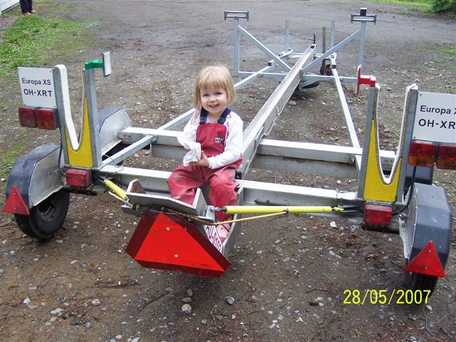

raimo.toivio(at)rwm.fi
PostPosted: Fri Aug 28, 2009 12:05 am    Post subject: Trailer wing cradle Reply with quote
Fred
Yes. That is an original factory trailer and I bought it from Germany almost as unused.
BTW it´s price was just 100 euros - do not ask why.
I made some mods like those wing cradles and what´s most important,
a second axle. I think that is a must like an insurance! It is quite usual to see a trailer beside road
and it has lost one tire and a serious accident has followed.
I asked myself what will happen to my Europa omboard on the trailer and such a thing happen?
We have dual filters, accus, ignitions, radios etc. to make our day - trailer w 2nd axle was the 1st in my safety list.
As we know - road traffic to and from the airport is dangerous and the most riskiest part of flying...
Later I add also a full floor to prevent shit, sand, mud and water to spoil my plane when trailering it.
Attached a photo - maybe the floor is visible.
Raimo OH-XRT
