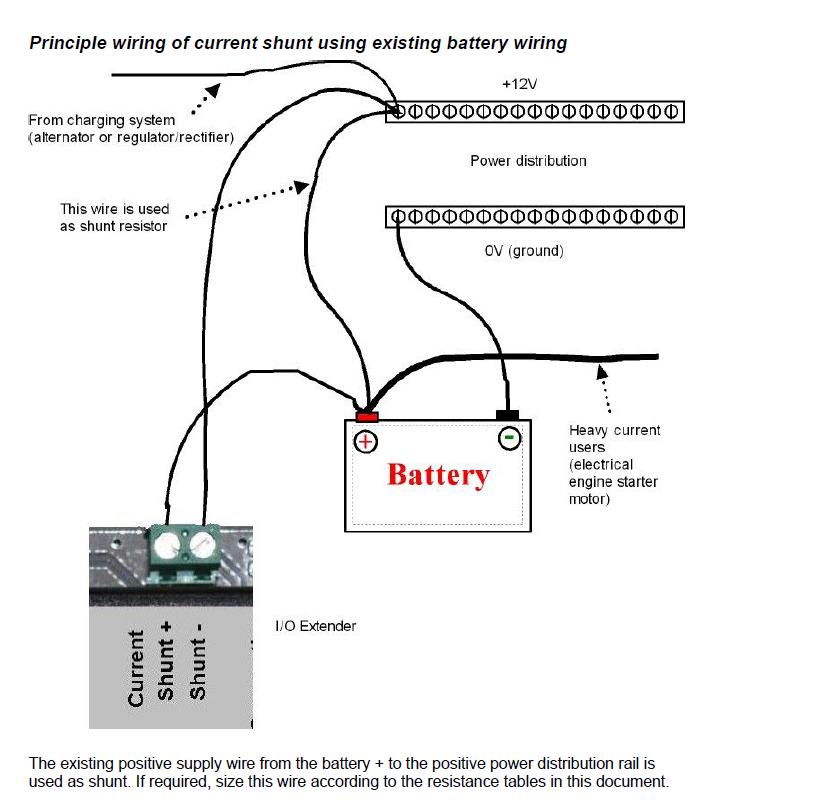

Don't understand the "stuff" that looks like an ammeter
shunt connection in the (-) lead of the battery. I appears
you may have taken a clue from the 'Connection about battery
(-) current monitoring shunts. That's an aberration that
needs to be removed . . . in fact will be at the next
revision.
Bingo! That's where I got it from. I doubt I'd use one anyway, since I could get the system voltage without one.

I'm planning on getting an Enigma. As I understand it, the stand alone instrument will give the system voltage without an additional shunt. So I assume voltage would be measured on either side of it's own load, or somehow reference the measurement to ground. Not clear on that.
If I want to measure current elsewhere, I need to get a separate shunt, or as they suggest, use the part of the system itself as a shunt. With any luck, I'll upload a their diagram of this.
So now I can monitor current wherever I place this shunt. Well, not quite. I have to buy their Input Output eXtender (IOX), a decent sized piece of hardware that the shunt wires plug into. There are several other fancy things that can be done with this IOX, but for me, there wouldn't be much else to use it for.

Is this what you see in my diagrams? I took the Z diagram and extended both the p_lead and the shield to show them hooked up at both ends. In the second diagram, I added the ground triangle to show that the dots connected to the little hoops went to ground.
I've learned alot, Bob, thanks. Lots more to go!
 Filesize:  69.07 KB
 Viewed:  36514 Time(s)
Dan
Where do they suggest this? I've poked around in
their downloads and was unable to find an install
manual for their i/o extender.
Then leave it off. It's a lot of money to spend
for so little useful data.
If you can accurately know the system voltage, then
it's easy to deduce whether or not the alternator
is keeping up, is over-burdened, or broke.
( . . . a long habit of not thinking )
( a thing wrong, gives it a superficial )
( appearance of being right . . . )
( -Thomas Paine 1776- )

Joe gave the link, I think. Here's what I read, starting on page 3:
Current monitoring
The I/O Extender provides a bi-directional current monitoring system. This is intended to
measure the charge and discharge currents to and from the aircraft battery.
Current is measured indirectly by measuring the small voltage drop created by current flowing
through a suitable shunt resistor. Typical shunt resistors are in the range of 0.010 ohm (10
milli-ohm) to 30 milli ohm. However, the current measuring system has been designed to
accept any shunt. In particular, you can usually use the +12V supply cable from the battery +
terminal to the power distribution system as a suitable shunt. Connect the I/O Extender shunt
terminals using two wires (these can be thin wires) to each side of the cable connecting the
battery + terminal to the current distribution system.
In this scheme, large, temporary current users such as electrical starter motors should NOT
be routed through the shunt. These should be wired directly to the battery via their starter
solenoids using adequately dimensioned cable.
Calibrating the shunt (known current):
The I/O Extender needs to know the resistance of the shunt in order to correctly calculate the
current flowing through it.
Our suggested method involves using a cheap digital or analog multimeter (they tend to have
a 10A DC range). Wire this meter in series with the shunt and switch some electrical users on
so you have a reasonable current flow (for example 2 – 4 A). Do not run the engine or have
any charging active for this calibration.
Using the connected EFIS, activate the current calibration and enter the amount of current
your meter is reporting.
Calibrating the shunt (known resistance):
If you are using a shunt with a known resistance, use the provided functions in the EFIS
system to set the shunt resistance value. This method does not require the use of a current
meter for calibration although we would recommend that you verify the current reported using
a current meter to ensure that your shunt resistance is correct.
Calibrating the “zero current” point.
This is a calibration that has happened at the factory but you can perform it yourself if
needed. The idea is to ensure that the I/O Extender returns a “0” current flow if no current is
flowing through the shunt.
For this, disconnect one of the wires to the shunt and connect it to the other side of the shunt.
Both wires will not be connected to the same side of the shunt (it does not matter which side).
Once this has been done, perform the “set current zero” calibration function in your EFIS
system.
Polarity of the shunt wires:
For correct operation the shunt wires should be connected so that Shunt + terminal connects
to the battery + terminal and Shunt – connects to the load.
This will ensure that charge current with be reflected as positive current reading while
discharge current will be reflected as negative reading.
About current measurement:
All current calibration should be done using DC current.
The I/O Extender system measures “average” current. This is NOT “RMS”. Many meters
cannot accurately measure A/C or pulsating currents. They can only give a good reading if
they are measuring a sine-wave (such as mains power).
Current through a typical aircraft shunt is best described as “pulsed A/C”. The charging
system provides short but powerful current bursts to the battery while the time between the
bursts the battery supplies current to the load. The battery is effectively changing between
charge and discharge all the time very rapidly.
The I/O Extender averages current measurements in both directions and returns the
averaged result of this. This shows the net charge or discharge current.
A normal battery, when fully charged, will show a small residual charging current (assuming
the charger is not overcharging the battery). This charging current is required to maintain the
battery charge as it is supplying current all the time (between the pulsed charge current). The
battery, depending on its chemistry has a charge efficiency of around 80% so it needs a
constant charge under these conditions.

Getting back to the The I/O Extender.
. . . . .provides a bi-directional current monitoring system. This is intended to measure the charge and discharge currents to and from the aircraft battery.
Measuring the current in or out of the battery is not very useful information because the battery does not supply energy to the aircraft under normal operations, the alternator does. Most homebuilders measure the output of the alternator, not the charging current of the battery. Even though MGL suggests installing a shunt in the battery circuit, their ammeter will work just fine with the shunt installed in the alternator output wire.
Joe
