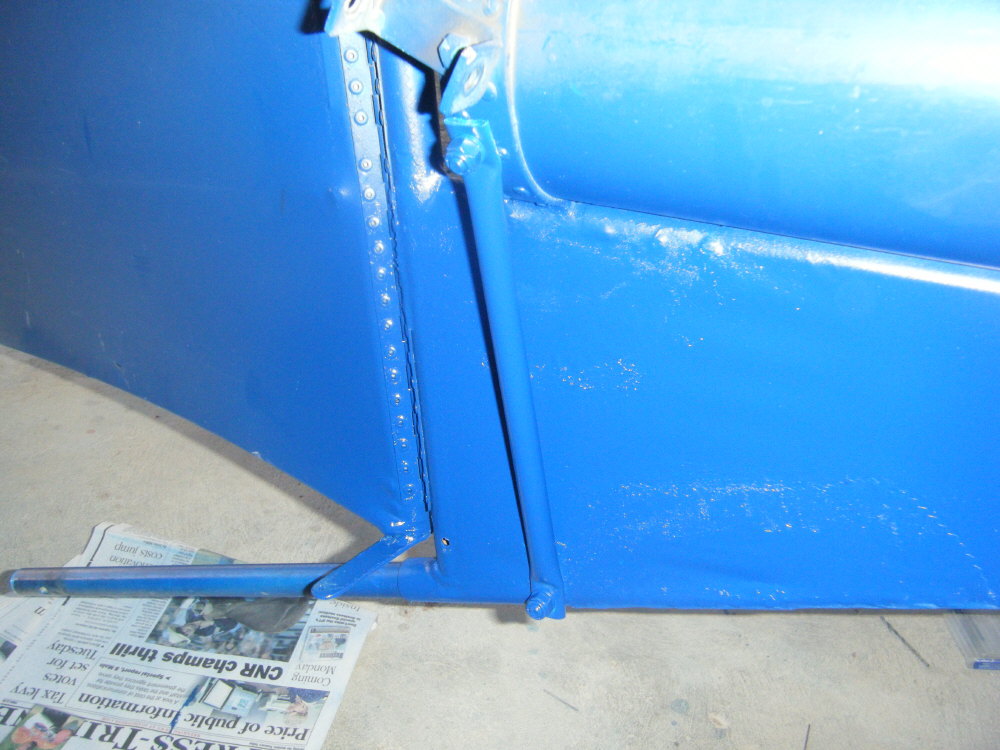

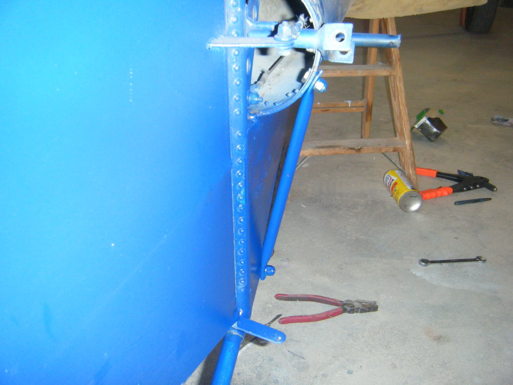

Some time ago John H suggested a fix for the tail wheel post and brace. It involved a brace from the tail wheel bolt to the collar on the tail boom. I should of paid more attention.
On the morning of Sept first, I was intending to go check the neighbors cows in the Pot Hole field to make sure none of them were bogged in any of the sink holes. Saves them some trouble and time and gives me an excuse to go fly.
As I was doing my preflight I noticed that the tail wheel assembly was wobbling. Sure enough the aluminum tube at the end of the steel collar was broken and the tail post was broken where it was connected to the collar on the tube.
I have 500.6 hours on the plane and most of it was on dirt, not grass, Dirt! Here it is soft and the worst side loads on the tail wheel are right in front of the hanger.
I now have it repaired, and this time I applied the side braces that John recommended. If you have not already done so, I would suggest that you make it a priority, because it is a pain to repair, but really easy to prevent.
[img]cid:3686A0B5207B43C6958AC4FC4B7907FE(at)larryPC[/img]
I sleeved the tube and welded the tail post. Of course the problem is the fabric repair.
[img]cid:77B6A3E065AA4FA49A345BFFEA492AB3(at)larryPC[/img]
These two little braces are easy to make and install, the repair is a pain in the butt.
Larry

Larry- Did you make the tubes out of steel, or aluminum?

I also had this failure.First the aluminum tube at the end of the steel tail post.Noticed the frayed fabric first during preflight because I fold and unfold every flight.So I replaced the tube (.032) with (.054) I think.But I continued to use differential braking to swing the FS around in front of the trailer,which puts a lot of side load on the tail post structure.Then the lower short tube from the tailpost failed at the ring.You know what that entails.I thought all of this was self induced by the way I was turning and loading the tailpost,so I spent the money and put a full swiveling tail wheel assy.on it.I never heard about the braces until John mentioned them one day.Then I saw the light.You can make the braces out of fairly light stuff because they are both in tension.The only other mod I made was the clamp on the tail spring at the steel tube to keep the rod from twisting against the bolt and letting the wheel flop over center.Also prevents fish mouthing of the steel tube so it does'nt get loose enough to rattle.
G.Aman MK-3C 475 hrs with Johns braces

Larry, is that aluminum or steel tube?BB
<77B6A3E065AA4FA49A345BFFEA492AB3>
Larry

PostPosted: Fri Sep 04, 2009 6:17 am    Post subject: Tail wheel support and brace Reply with quote

That is an excellent and easy mod to do. I was going to weld the braces on mine, but given what I see in your pictures, your mod looks jut as strong and does not have any of the drawbacks of having to weld. I will make that a priority and do it soon. Given this number of reports of breakages in this place, it is something I check on EVERY preflight.
