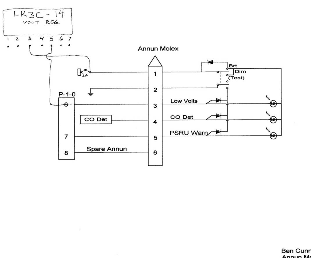

I recently purchased the LR3C-14 for my RV7.
My panel was constructed by Aerotronics and I have added a diagram below of the schematic for my annunciator lights.
I have done a sketch below of how I would like to wire the LR3, with terminal 5 feeding the light through plug P-1-0, and terminal 3 reading buss voltage downstream of the 2 amp breaker. Since the light was wired through a test switch, I wanted to run this setup by you to see if it looked OK to you.
 Thanks, Ben
