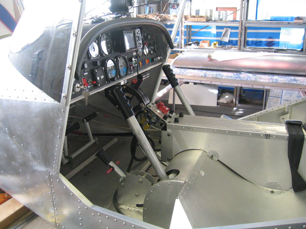

PostPosted: Wed Aug 19, 2009 9:10 am    Post subject: Dual sticks Reply with quote
Joe, have a look at this one, nothing wrong with the Y.
This is just preference, I'm a south paw, grew up on this config.
Thought to make a slow flying plane fit my habits.
All the best,
Dirk in Africa

PostPosted: Thu Aug 20, 2009 5:55 am    Post subject: Dual sticks Reply with quote
Don't cut the "Y" off. If you can weld then it is not difficult to
duplicate the bottom part and make a complete dual system. That way you
have both. All I have to do to replace the duals with the "Y" is remove
two bolts and unplug the wiring. Then you can switch back and forth.
Let us know which you like best.
Remember when building the sticks, to put a large "C" in them (see my
pictures). If you make straight sticks then you will have difficultly
getting in and out. With the "C" it real easy to get in and out.
Take care, Larry N1345L

lrm(at)skyhawg.com
PostPosted: Mon Aug 24, 2009 10:09 am    Post subject: Dual Sticks Reply with quote
To the guy who originally posted the following:
"Iam about ready to put dual sticks in my 701. You cut the Y stick off
at the connecting point, then weld a 24 inch tube from left to right.
Then weld two upright sticks on top of the horizonial tube. I assume you
put the elevator in zero position then weld the upright sticks. Iam
told that the upright sticks should be moved forward about 20 degrees
before you weld them."
During that crap with Joe Spencer I realized that no one really answered
you questions. So I will give you my opinion.
First use bent sticks not straight ones. Straight sticks make it very
difficult to get in and out. The bend should be in the shape of a "C"
with a straight tail on the top end to allow for the grips.
Put your elevator in the maximum down position with the stick in the as
far as you can reach position. Mine ended up directly under the
instrument panel. You will never use it that far anyway unless you are
dive bombing. Weld it there. You have cables to make fine adjustments.
The other advantage in having it so forward is that it really makes it
easy to get in and out and it's out of the way when not in use.
Don't worry about vertical movement, it is a non issue and actually is
an advantage because you have a little less horizontal movement. It
does not interfere with the other guy. And if you pin the co-pilot side
that's another advantage over the "Y".
I also suggest you try and fabricate an entire new setup rather than
cutting up your "Y". Then you can try both and make up your own mind.
Or sell the "Y" to one of the die hard purist.
I have quite a few hours with this dual stick arrangement and wouldn't
consider a "Y". I've flown with the "Y" also and there is no comparison
to the dual for convenience and ease of use.
