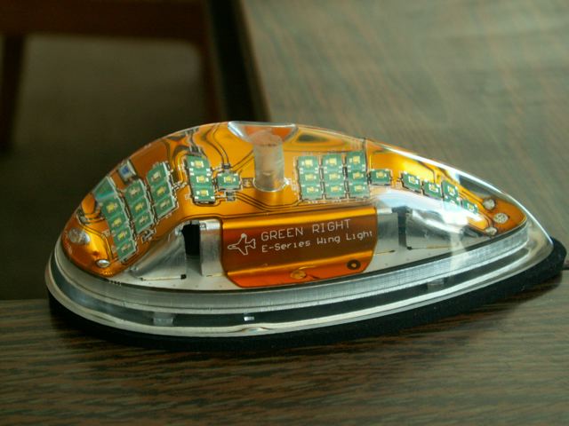

Hi, Mike!
I'm a big fan of the Aveo Engineering wingtip units, which combine strobe, position lights, and rear-facing white position lights all in one unit. This means you won't need the white position light on the tail, just the two wingtip mounted units (which connect directly to aircraft power - no power supply box!).
Better yet, they draw a mere pittance of electrical power, will save you over 4 pounds of weight when compared to the typical strobe/power supply installation, and come with a lifetime warranty. Best of all, they're over twice as bright as what the regs require for airframe lighting. And since they're completely sealed and potted in a super-tough clear acrylic material, there's no internal condensation (as I've seen with competitors).
I was so impressed with these things when I first saw them at AirVenture 2008, that I signed up to be a reseller (California only). We have a hard time keeping them in stock in our retail store. A pair lists for just under $700.
I've attached a photo for your amusement.
(I'm putting a pair on my own 601XL, so if anyone needs a traditional nav/strobe/rear position light setup, let me know. The items I'm removing have less that 120 hours on them.)

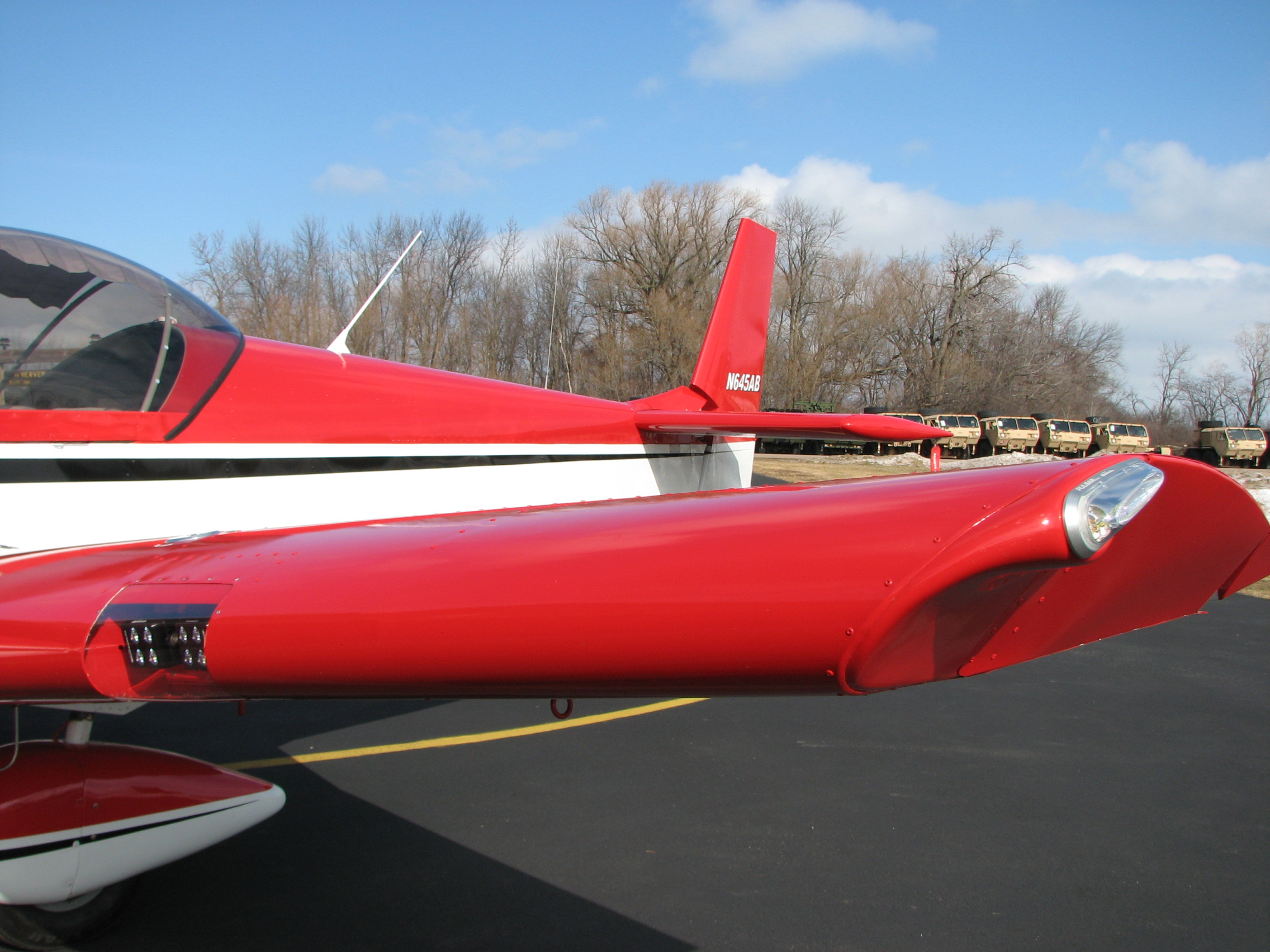

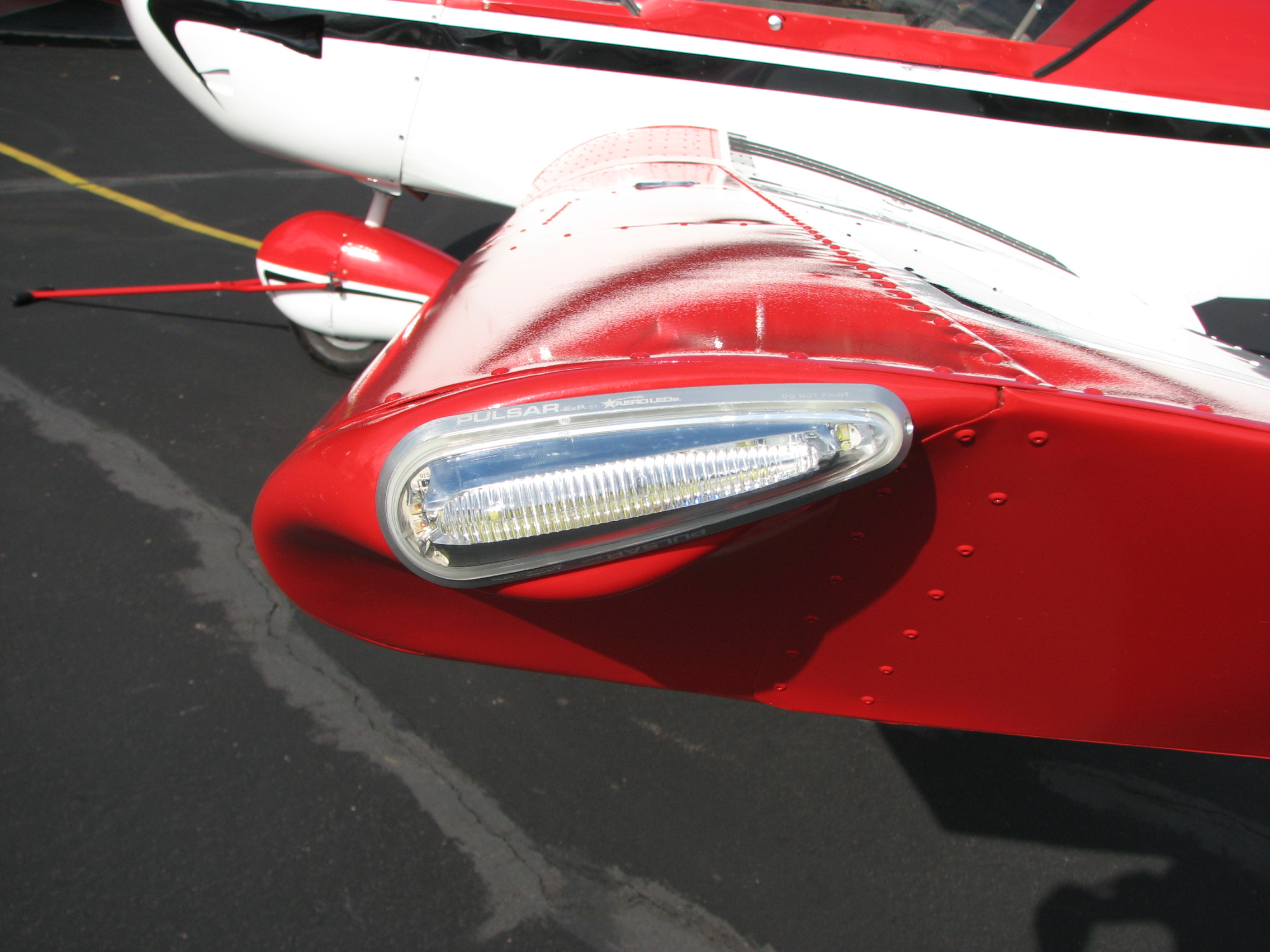

Mike,
If you don't like the looks of lights that look like they were made from a kit from Radio Shack take a look at the lights from AeroLED's. I have them on my plane. I also have their Landing/Taxi lights which are also very nice. See the attached pics of each. Zenith is selling them now (Best price around).
http://www.aeroleds.com/
Al from Oshkosh
