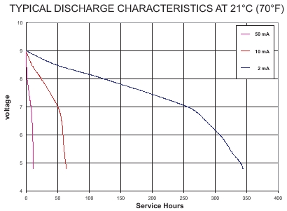

[img]cid:.0[/img]
A Duracell 9v has published performance data as shown
above. The smallest discharge curve is for 2 ma
so with a end of life voltage of say 7 volts, yes
the device should deliver 500 mAh of service at
2 mA and MORE at still smaller drains. The internal
resistance of the battery becomes less significant
as current demands drop . . .
