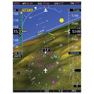

Robin Marks wrote:
[quote]--> RV10-List message posted by: "Robin Marks" <robin1(at)mrmoisture.com (robin1(at)mrmoisture.com)>
I have been looking at the GTS-800 for my G900X. I currently have TIS
Traffic which is fantastic where TIS is available. Unfortunately half of
my regular commute the TIS drops off "Traffic No Longer Available" and
then you are on your own. Or as I call it "old school." When TIS is working it is a real comfort in the congested Los Angeles
basin where there can often be a dozen aircraft within a few miles of
you all going different directions at various altitudes and speeds. Most
of which you can't see. Helicopters seem to be the worst as they are low
and stationary. I am based where many of the heavy lift fire fighting
helicopters stage for fire & rescue (currently working the Station
Fire). Plus most all the local network news choppers so there is a lot
of roto activity. The other night I was departing WHP after 8:00 pm,
the tower was closed so I was in communication via CTAF with a NEWS
chopper flying low. I could not see them visually but had them on the
"fish finder." Because we were in communication and he had sight of me I
was able to fly right over the top of him (+1,000') and I confirmed he
was at 2,000 MSL. He responded with a surprised affirmative. I knew this
because I was climbing through 3,000 and my PFD showed "-1.0, -1.1,
-1.2..." and his direction vector. When I visited Deems in mid-summer. Yes visiting Deems in AZ in
mid-summer. Duhhhhh. We were 8 miles out lining up for DVT with probably
7 other aircraft in the area. None were easily visible out the window
however I did see them on the display. It looked like herding cats as
they were all going different directions at different altitudes & speeds
but I could see as they all made their random turns for extended Left
Base entry to DVT. It was cool to see these random indications all line
up in front of me. With the visual verification I was able to easily
slide in with adequate spacing and set up for arrival. Nothing beats two
eyes out the window but Traffic is a wonderful additional tool to have
at your disposal.
Robin

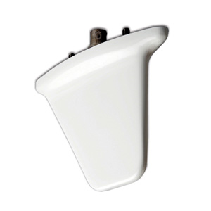

John, it depends a little on what you do with your system, what
antennas are required and where you mount them.
First, you do definitely need a shark fin type Transponder/DME
blade on the belly. This is for receiving the ADS-B Ground
station signal, and later if you add the transmitter board
it will be for transmitting your information to the stations.
I wouldn't choose any other antenna then a shark fin blade
because of the frequency requirements.
Next, many people will want to mount a GPS antenna somewhere
on the top. On mine, since this one isn't critical for
navigation, I actually mounted mine under the very front of
my Vertical/Horizontal Stabilizer fiberglass fairing. If it
were a navigational antenna that wouldn't have cut the mustard
for me, but for this use I'm fine with it. Mounted there,
it makes the ideal location for mounting the avionics box
to be in the tail somewhere.
There also is the possibility of feeding in a GPS signal from
a properly configured and equipped panel mount GPS. The
specs on what is required for a GPS signal are fairly
high, and most common handhelds and other GPS's won't meet
the needs. I think the GNS480 does with the current new
software, and I'd hope that a 430W meets it too. But, to
make it easier and not have to worry about integrating a
GPS and hoping it is wired right and works, I just did the
built-in GPS.
So those are the 2 antennas required. It's not like
active traffic where you will want 1/2/4 antennas mounted
in various places for getting good signals from the other
aircraft...so it's a little simpler to install.
Tim Olson - RV-10 N104CD

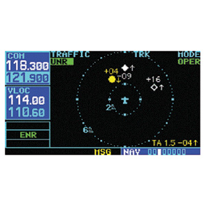

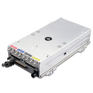

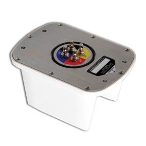

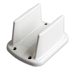

Garmin recently updated their public site to include photos of the GTS series modules and antenna including the underside of the dual blade antenna.
https://buy.garmin.com/shop/shop.do?cID=270&pID=14664
I have to say the images of the traffic on the site do not do the traffic system justice as the extreme zoom feature of the MFD allows you to really pick out individual targets of most concern.
Robin
[img]cid:image001.png(at)01CA3072.8C2A7C40[/img][img]cid:image002.png(at)01CA3072.8C2A7C40[/img][img]cid:image003.png(at)01CA3072.8C2A7C40[/img]
