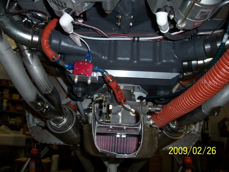

I have no problems following AFS's recommendations as others here have also noted. The engine shop provided me with the new hoses.

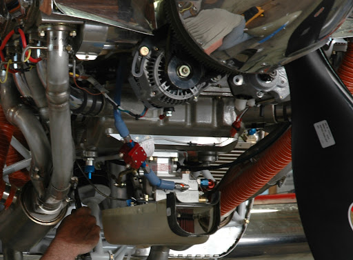

PostPosted: Sat Aug 15, 2009 4:04 pm    Post subject: Fuel Flow variations Reply with quote
I found photo's of Rob Hickman's installation:
http://lh6.ggpht.com/RobHickmanAFS/SNltW4FJUII/AAAAAAAAAQo/sX7EW06y0Zg/s800/
Gary Blankenbiller's at:
http://www.wingscc.com/n2gb/FF1-Engine/100_3207.jpg
Looking at the install procedures for the EI FT-60 on EI's site (which is
used by several of the EFIS vendors):
1. Find a convenient location between the Fuel Servo and Flow
Divider and away from any hot exhaust pipes to suspend the
Fuel Flow Transducer
dave.saylor.aircrafters(a

By all means consider moving the location to the front, especially
if you haven't done the install already per the plans, but for those
who already have the sensor in place, think about this before you
make a modification from the Van's plans- new hoses?, new setups?..
ask yourself with this information if it's worth the effort?
Just bringing a difference perspective for anyone who worried about
this, as I did initially.
Tim may have changed his mind on this, if so Tim please advise.

On Aug 16, 2009, at 2:18 PM, Tim Olson wrote:
Nope, I'm still very happy. As far as access to the sender goes,
I've never had reason to touch it since it was first wired in. It
works plenty well for me and I can usually plan on the reading being
dead on when I refuel.
Tim
