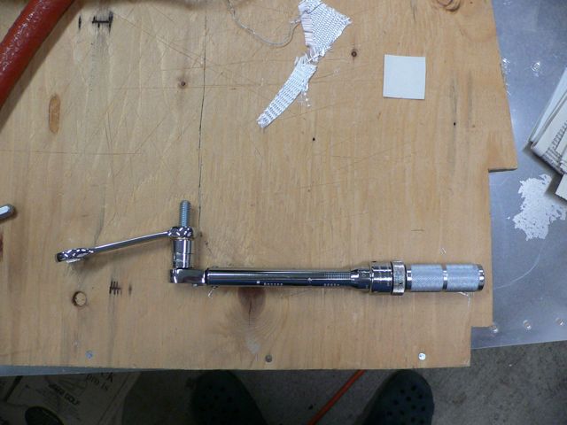

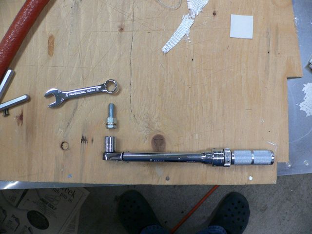

You can cobble together an equivalent device. I used a very short
(about 3" long) combination wrench, a bolt, a washer and nut and some
duct tape. The washer is put over the bolt, then the nut is screwed
on tight. This is used to transfer the torque from the socket on the
torque wrench to the closed end of the combination wrench. Use some
duct tape to secure the socket, bolt, washer, nut and combination
wrench together. Of course you'll need to apply the standard
correction to the torque wrench setting to compensate for the extension.
