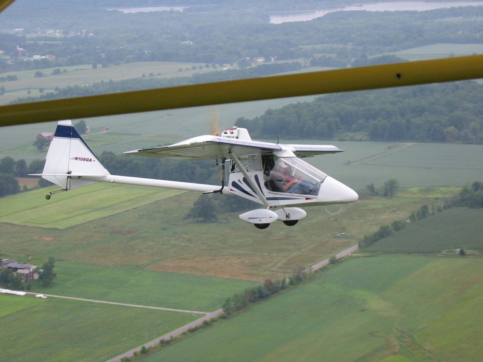

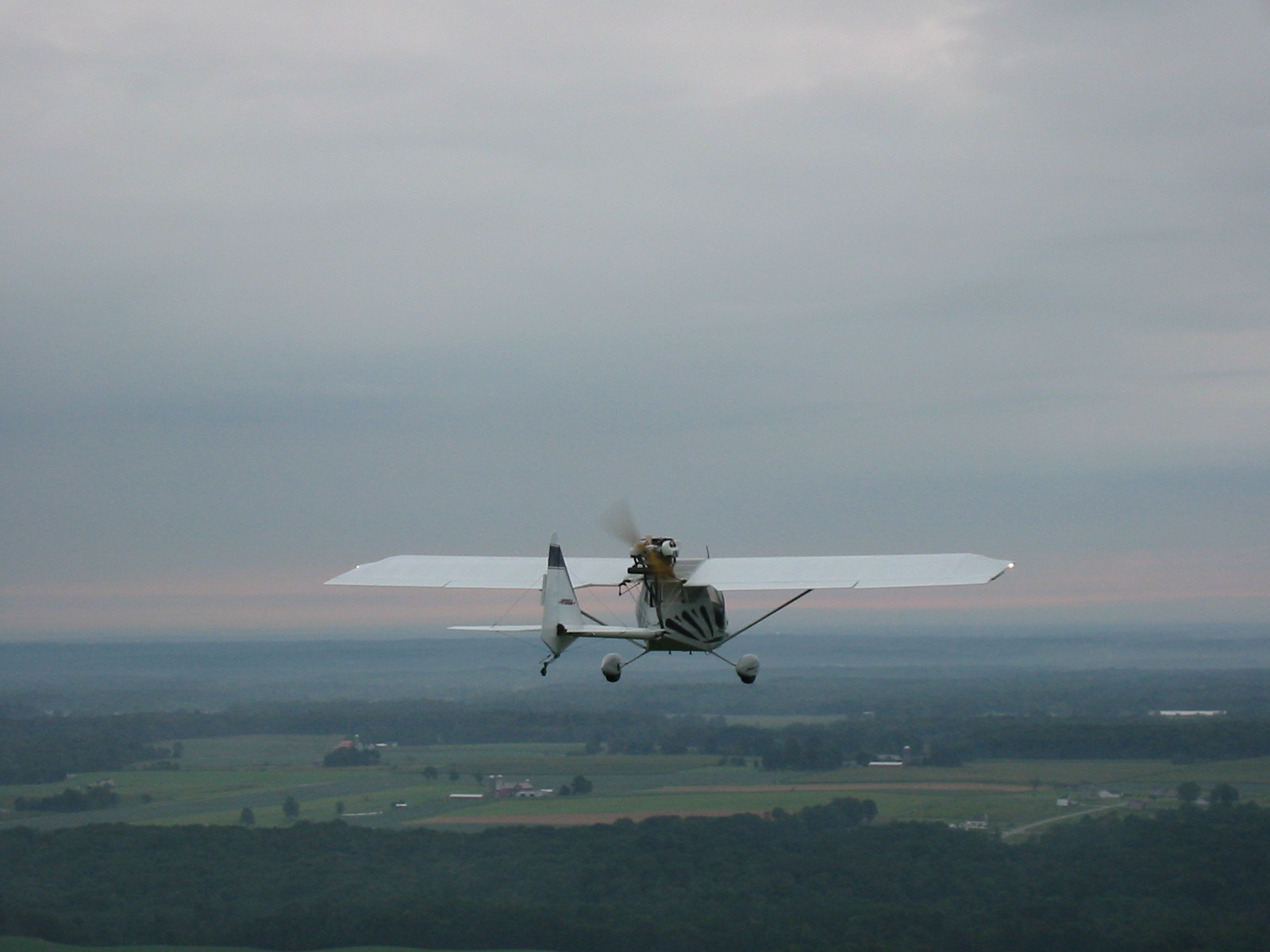

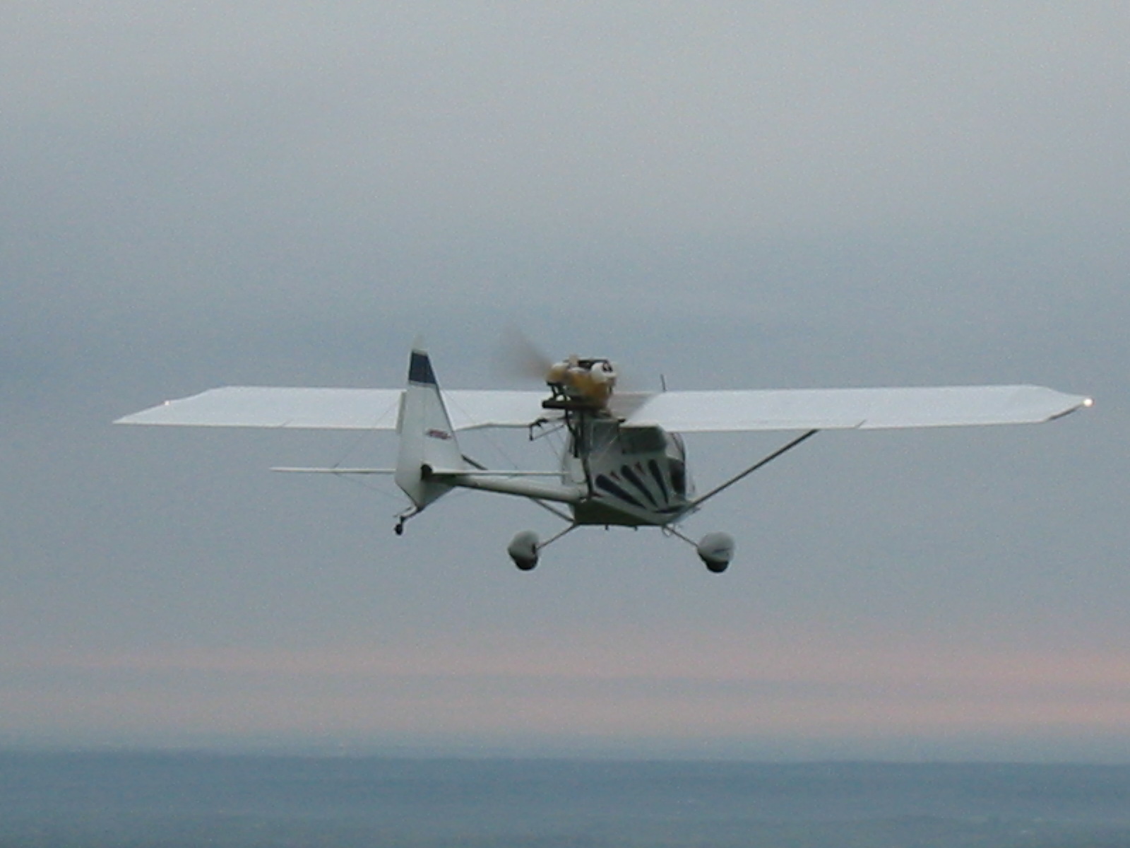

Got caught by a camera on they way to breakfast Sunday.Not that nice a day for flying but at least it's Kolb related.Taken from a friend's Chinook over NE Ohio.

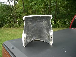

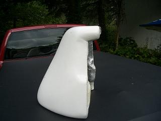

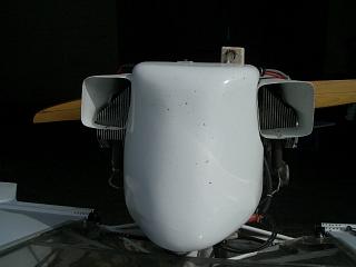

Nice photos of a nice Aussie powered Kolb. In the second photo I see something foreward of the engine that is white in color that looks to be a fairing of some sort. Can you tell us what that is?

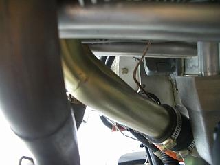

Also noticed your extended exhaust system. That surely gets the carbon off the prop. Have you noticed any other difference with the exhaust extension?

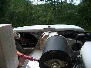

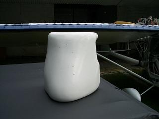

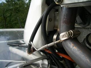

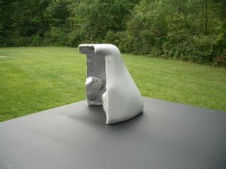

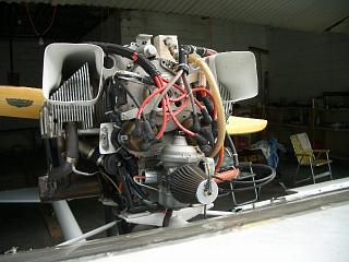

The fairing covers completely the aft end of the engine enclosing the distributors, coils and the upper half of the carb.It also directs a smooth air flow to the cooling shrouds.I can't take any credit for the design for it was installed when I purchased the Mark from Will Tatham . I will get some pictures that show it's design clearly,for it is easily removed with 3 an3 bolts in less than a minute.I don't beleive it weighs a pound.
The exhaust is strictly home brewed.Noise abatement in the cabin was the motivation for this.That part worked well,no power loss BUT,if you have ever felt the air movement coming out of the cabin end of the fuselage tube, just add exhaust to the mix.Had to make a 4" foam gasket in the tube to keep from getting gassed.The chrome tail pipes are VW and they quiet things down OK but after 150 hrs the baffles are gone and I need to unweld the pipes and replace them.

I'd very much like to see the photos of the fairing.

Attached,3 at a time

Thanks again. The photos are a great help.
That fairing sure cleans up that area nicely. Do you suppose the carb inlet is getting relatively low pressure air aft of the fairing? I know Bing says not to subject the air inlet to high ram air pressure, presumably due to its potential affect on automatic mixture control.
