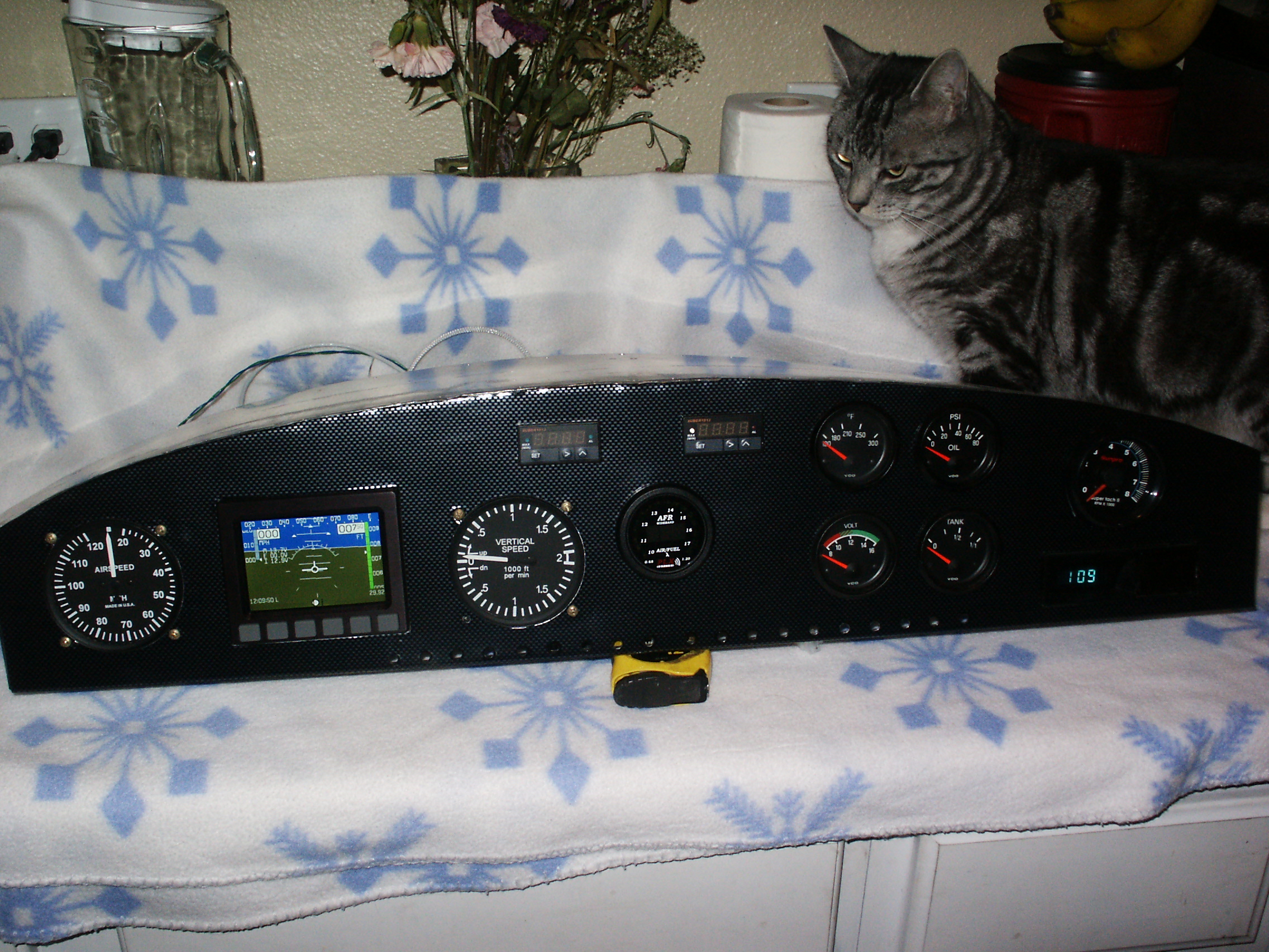

  Having a combination of analog AND digital gauges is what lead me to build my panel.
  Here is what I came up with;
A) digital Dynon D10A Electronic Flight information system C which includes the following functions...airspeed C altitude C magnetic heading C AOA C ROC C turn coordination C and an artificial visual view of outside
B) digital wideband O2 sensor C with programmable alarm for exceeded air/fuel ratios
C) digital turbo charger boost gauge C with programmable excessive boost alarm
D) analog fuel C oil C water temp C volts gauges
E) digital clock (Honda Civic C IIRC)
F) analog airspeed gauge
G) analog vertical airspeed
  Each guy will have his or her own preferences C with regard to gauges.  None are wrong C just looked at from different angles.
  Here's a photo of what I came with........
Mike Welch
MkIII CX C 90% done C 90% to go

Hi Mike. I like the looks of your air speed indicator. Could you give me the model and source. Thanks, Clyde
mdnanwelch7(at)hotmail.co
PostPosted: Tue Aug 11, 2009 3:59 pm    Post subject: Need advice on instruments Reply with quote
Clyde C
UMA Instruments:
Airspeed Model# 16-310-120 C Vertical Speed Model#8-310-20
  I purchased them from a guy on eBay that decided not to build an airplane C after he had purchased many of the necessary parts.  They were (and still are) brand new C and I paid $120 for the pair.
  I also have a different airspeed indicator I bought on eBay.  It's new C too C but it says "CPS" (California Power Systems Logo) on the face.  It reads up to 100 mph.  If I were to use it C I would take it apart and paint over the advertisement.
  Since I found a different set (the UMA ones) I let the CPS unit sit on a shelf.
