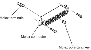

Another interesting feature is what appears to be
rear connector plate options. The stock input/output
connector plate works with the same Molex wires-to-
ecb style of harnes connector . . . same as the A200.
The A210 install kit comes with an "MB-113" adapter
module to convert the legacy molex connnector interface
[img]cid:.0[/img]

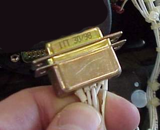

To the more robust Dsub 15 connector.
[img]cid:.1[/img]
If we look at the A210 installation data . . .
http://tinyurl.com/nxw5jm
. . . we see that half of the 30 wires available
in the Molex pin-out are available in Dsub
pinout and in different combinations. For example,
only 2 of the 6 power/gnd connections are available
in the Dsub. The Molex doesn't offer the RS232
GPS interface option. The Molex connection offers
3 aux audio inputs, the Dsub offers only one.
Certainly, the Dsub pinouts offer enough
features to accomplish a perfectly useful installation
in an airplane.
Getting back to the intercom issue, we see that
there's a raft of menu driven audio performance
setup features. Further, pin 10 (intercom enable)
in the Molex connector does not appear on the
Dsub connector. Admittedly, with out a schematic
of the MB-113 adapter, we don't know if Molex 10
is simply ignored or is tied to ground by the
adapter. Further, functionality of the intercom
ground to activate connection is not explained. It's
illustrated in the Molex wiring as a useful thing
to attache to an intercom PTT button, but in the
user's manual . . .
http://tinyurl.com/nsvye4
the use of this push button is not explained. However,
on the description of panel controls we see that
item (1) DUAL SWITCH has a time-based function
(hold for 2+ seconds) to turn the intercom function
ON or OFF.
It would be nice if the manuals were more complete in
this regard. I'll keep an eye open for the service
manual on this radio. Schematics are VERY useful in
figuring out how things work. Does anyone on the List
have an A210 installed and working who can help Alan
sort through this radio's intercom functionality?
