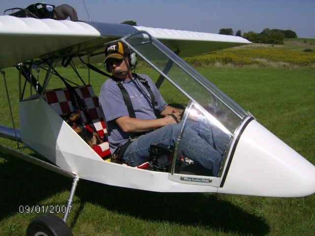

PostPosted: Fri Aug 07, 2009 3:33 pm    Post subject: Re: W & B, cruising, stalling and landing Reply with quote
I agree... Magic...
I named my plane "Miss Lucky Stars"
Every time I'm flying... I'm thanking my Lucky Stars ...
Gotta Fly...
Mike & "Jaz" the Flying dog
