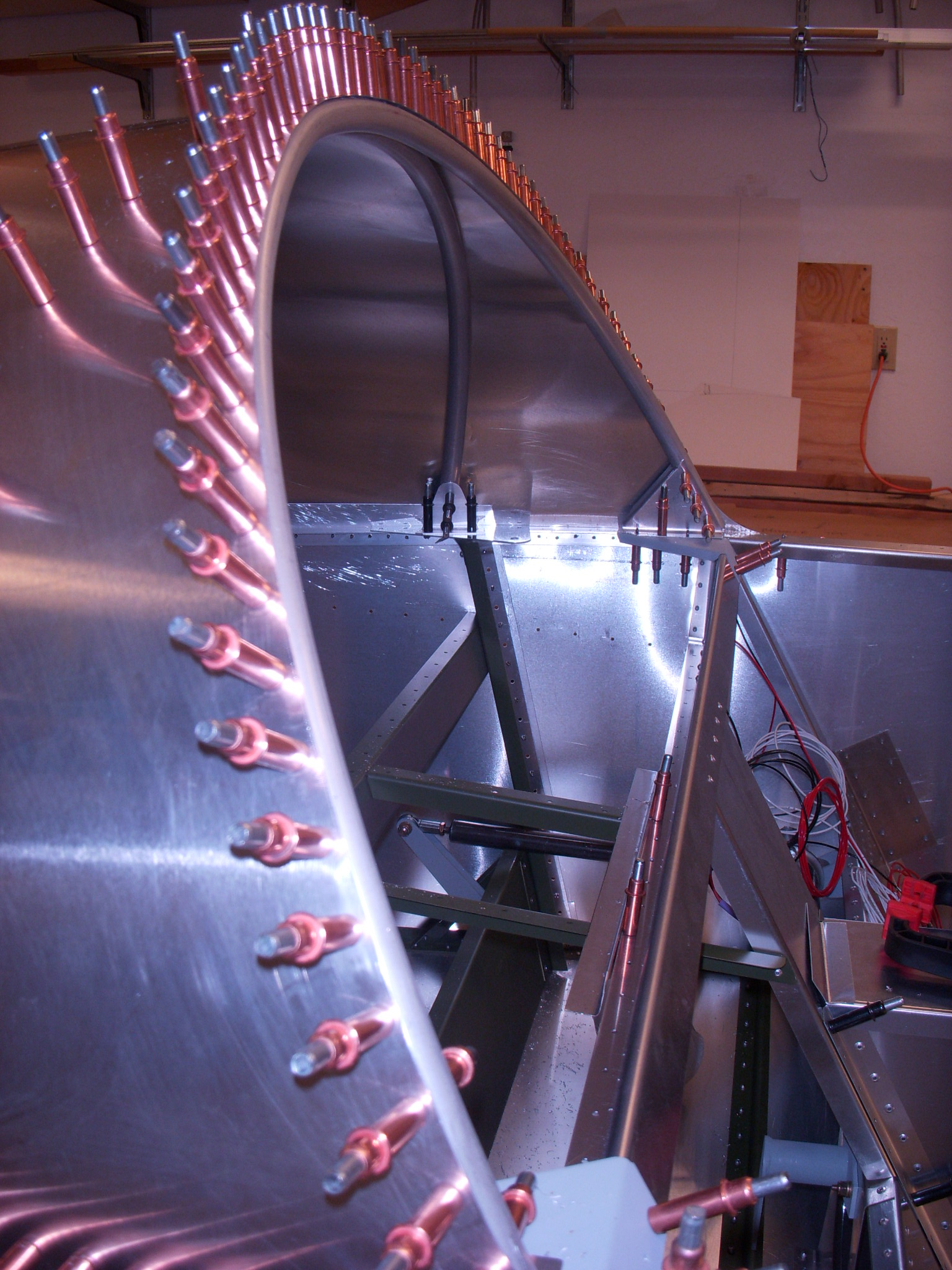

To minimize the dreaded "buckled edge" on the roll over: double the rivets along the edge, ie. every 25 mm, and cut the edge distance to 7mm. Use a rubber or plastic hammer and go slowly. (picture attached)
This same philosophy works at the longeron as well.
