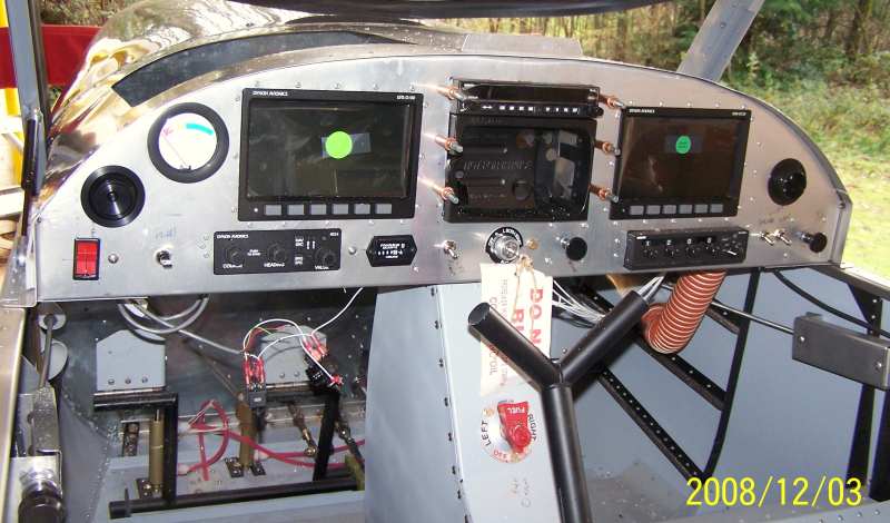

Hi Chris,
I installed the full engine and controls before considering where my electronics might wind up. This worked well. The engine controls are very sensitive to location, but the electronics are pretty flexible as to exact location.
When installing the electronics you will need to design and implement some sort of structure to attach the various boxes to. This may take up some room - particularly between instruments and radio/electronic stacks.
Of course, all of this stuff must stay clear of the cables and other stuff needed to control the engine. You will need space to service the engine controls too.
My solution (mostly copied from other people's approaches) was to cut two large inspection holes in the top skin between the instrument panel and fire wall. This allows easy access from the top and also some access to the very low spots on the instrument panel from the bottom.
See the picture below.
Good luck,
Paul

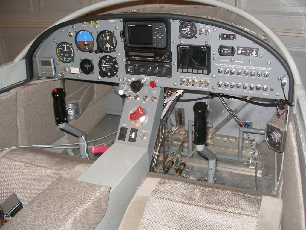

Chris,
I have pretty much this same set up; except Narco transponder and controls for Carvair engine. It works for me. See drawing. & photo.
Jay Bannister
 Filesize:  182.05 KB
 Viewed:  5614 Time(s)
