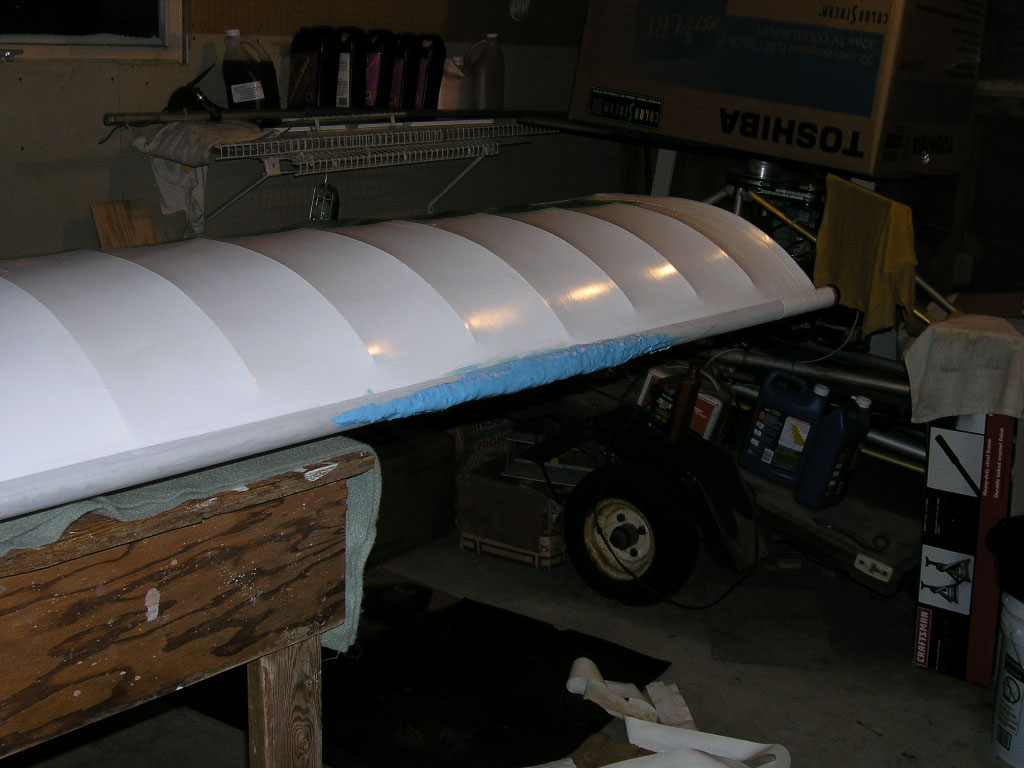

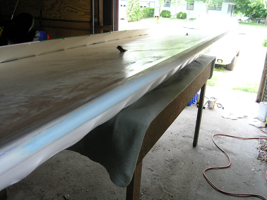

PostPosted: Wed Aug 05, 2009 3:24 am    Post subject: Re: Freak accident Reply with quote
I have just the solution for you. For small dents, use the Poly Fiber light weight epoxy. Take the finishing tape off the leading edge if you have it, apply the epoxy liberally, sand to a smooth finish, apply new tape, and paint. I sanded mine by hand and made a template of cardboard to check the leading edge curve as I was sanding. If you do it right, it looks like there never was a dent.
Ralph B
