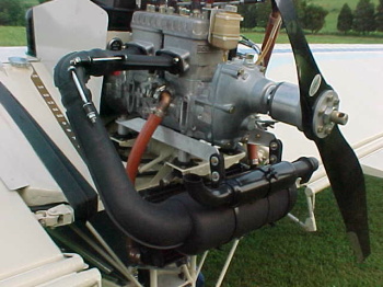

PostPosted: Tue Aug 04, 2009 5:24 pm    Post subject: Re: HKS oil cooler damage Reply with quote
Not sure how your oil cooler mounts so this may not apply, but I have used rubber exhaust hangars for years to hold up the muffler with no problems. Buy them at Advance auto parts, grind off the rivet that holds them to the metal hangar strap, throw away the strap, keep the rubber. Cost about $3 a pair. Replace every third year.

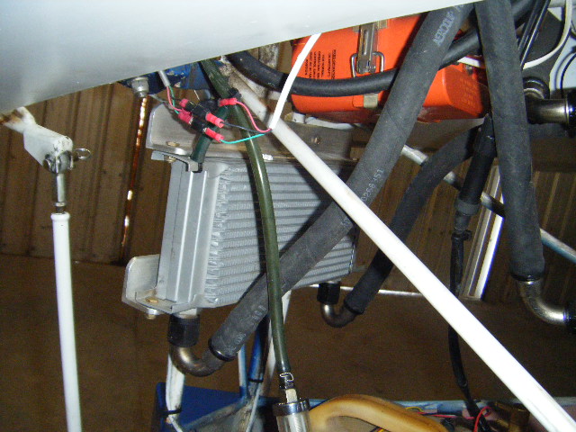

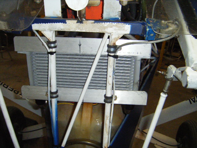

PostPosted: Wed Aug 05, 2009 11:28 am    Post subject: HKS oil cooler damage Reply with quote
 Filesize:  112.97 KB
 Viewed:  5350 Time(s)
 Filesize:  110.81 KB

PostPosted: Wed Aug 05, 2009 11:53 am    Post subject: HKS oil cooler damage Reply with quote
The length and rigidity of the hoses are key. Yours appear to be long enough to solve the problem.My 3cyl is a born vibrator and I wanted everything compact as possible, so with my short hoses in consideration
I mounted both the water radiator and oil cooler on a semi floating framework attached to the front
of the engine. They all shake somewhat in unison. Seems to be working out ok. I'll keep an eye on it.
BB

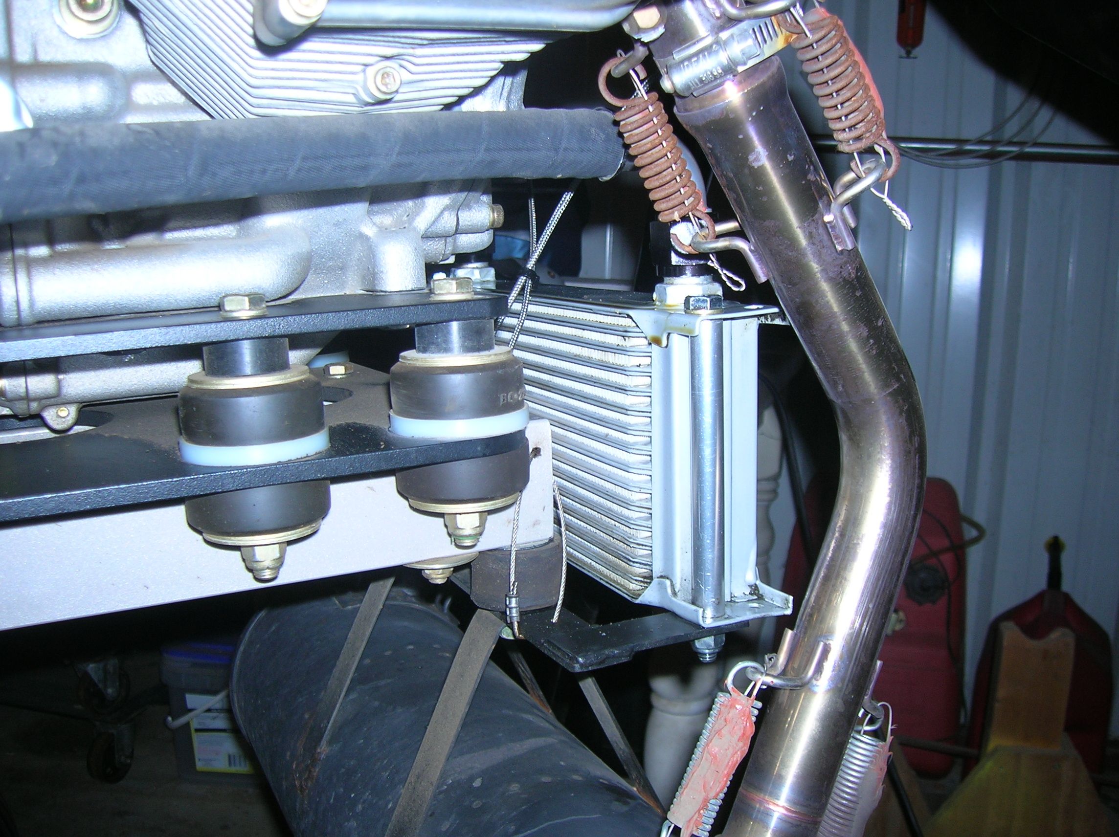

PostPosted: Wed Aug 05, 2009 2:53 pm    Post subject: HKS oil cooler damage Reply with quote
At 03:24 PM 8/5/2009, Larry Cottrell wrote:
I am surprised that the stiffness of the hoses could cause enough stress to crack the cooler. Could there be any other factor? Below is a picture of my mounting.
It's not the stiffness of the hose, but the mass of the oil filled hose vibrating.
-Dana
