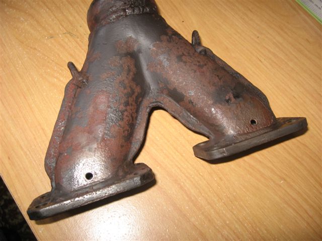

I'm resisting the tempation to buy a new manifold and start over. In the
cleanup prior to begging a welding shop to close up the holes I noticed that
there actually were holes in approx the right place that have been welded
over in order to put the holes in the wrong place. Here is where the guy put
them, little too close.

PostPosted: Thu Aug 06, 2009 8:28 am    Post subject: egt probe, wrong location how bad Reply with quote
On 08:02 AM 8/6/2009, Dave G wrote:
Here is where the guy put them, little too close.
WAYY too close. As I recall, the Westach probes were supposed to be something like 2 1/8 inches away. I can't remember the exact distance, but for some reason 2 1/8 sticks in my mind. It was clearly closer to the mid point between the "Y" and the piston end of the manifold.

The correct placement is 100mm or 4 in. from the rear of the piston. Drill the holes in the center of the exhaust tube. You can just plug your old holes up. You can tap and put screws in the holes, but they must be safety wired. Too close or too far will give an in-accurate reading and although you will see a trend you won't really know what the engine is doing. The better and more accurate readings you have the better you can run and tune the engine and know when things are not right before it is too late.

PostPosted: Thu Aug 06, 2009 1:12 pm    Post subject: egt probe, wrong location how bad Reply with quote
Holes are plugged and redrilled in the proper location, ~100mm and the
manifold is painted andback in place. I do wonder what reason the old owner
had for changing the location. Never know I guess.

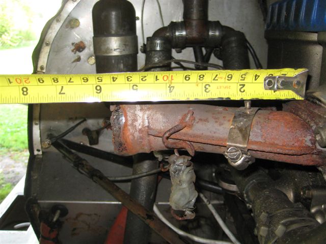

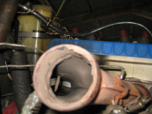

1 5/8" from cylinder port casting on a Kitfox with inverted Y pipe ( not to mention a hacked one that costs Kitfox 582 driver about 5 to 7 HP . I run the hacked Y pipe and a tuned pipe. Yeah baby and it works great with less fuel burn. Over 400 hours testing on this pipe alone and on ethanol gas. Woof !!
I just went out to shop and looked at several clamp style EGTs one on my 582 and it about the same as a 532 Kitfox as well.
