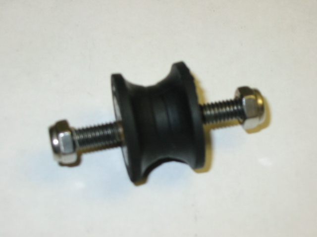

Richard,
We had that issue on a HKS on a Hawk.The mount does not expand but the aluminum cooler will expand .015 for every inch of length as it heats up.We used these hourglass mounts from JBM
to secure the cooler.That was 4 years ago so I can't say how long they will last,but so far so good.
Might try JBM's stainless steel springs on the exhaust also. G.Aman

Gary:
Looks a lot like the Rotax 582 radiator shock mounts I use on my coolers.
[quote] to secure the cooler. G.Aman
