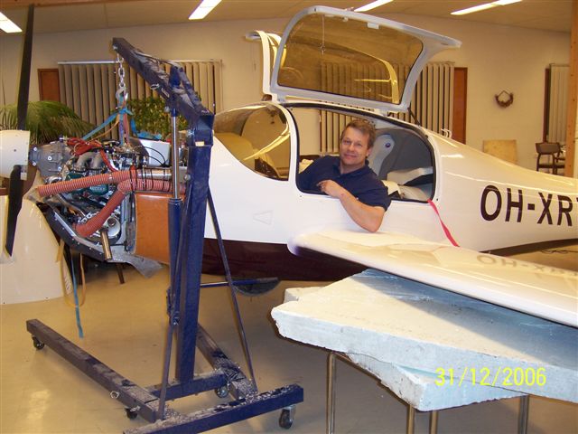

Look at the attached pic about 2˝ years ago - my Europa was not flyable yet.
Those foams under the wings were only to balance the plane - not for load at all.
And I was there in (first time) retracting and tracting, retracting and...
